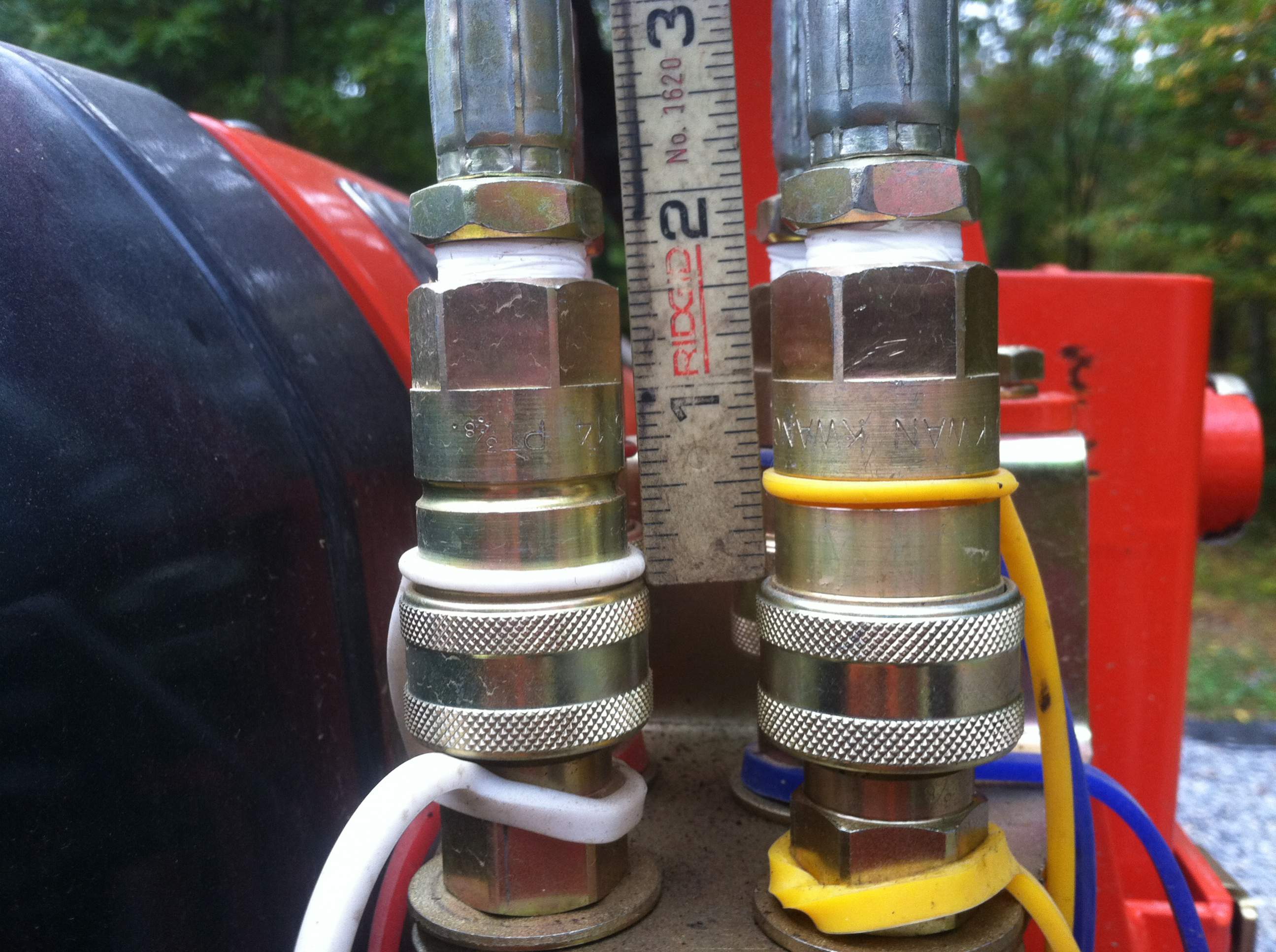

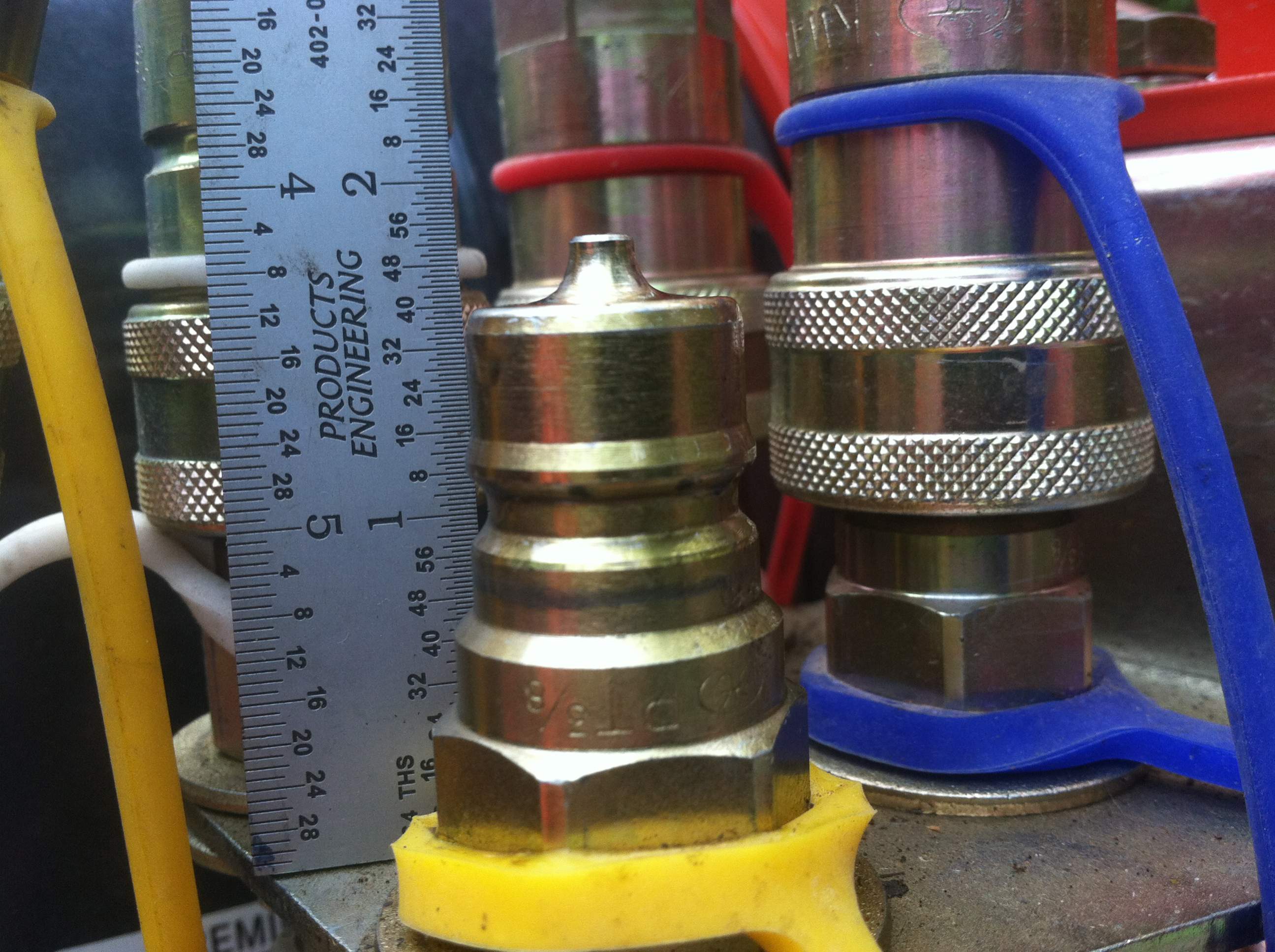

Kioti owners, I am trying to help Chuck with a gauge setup but we need to verify the proper QD's used on his CK35. Here is the info we have so far:
The loader quick connects: Kwan kwang 14 pt 3/8
The remote quick connects on the plastic cap: pt 1/2
I found a KwanKwang catalog HERE but my foreign language skills are a bit lacking.
Anybody know what couplers are used? ISO 7241's or ISO 5675? Any pics up close with a ruler would help also.

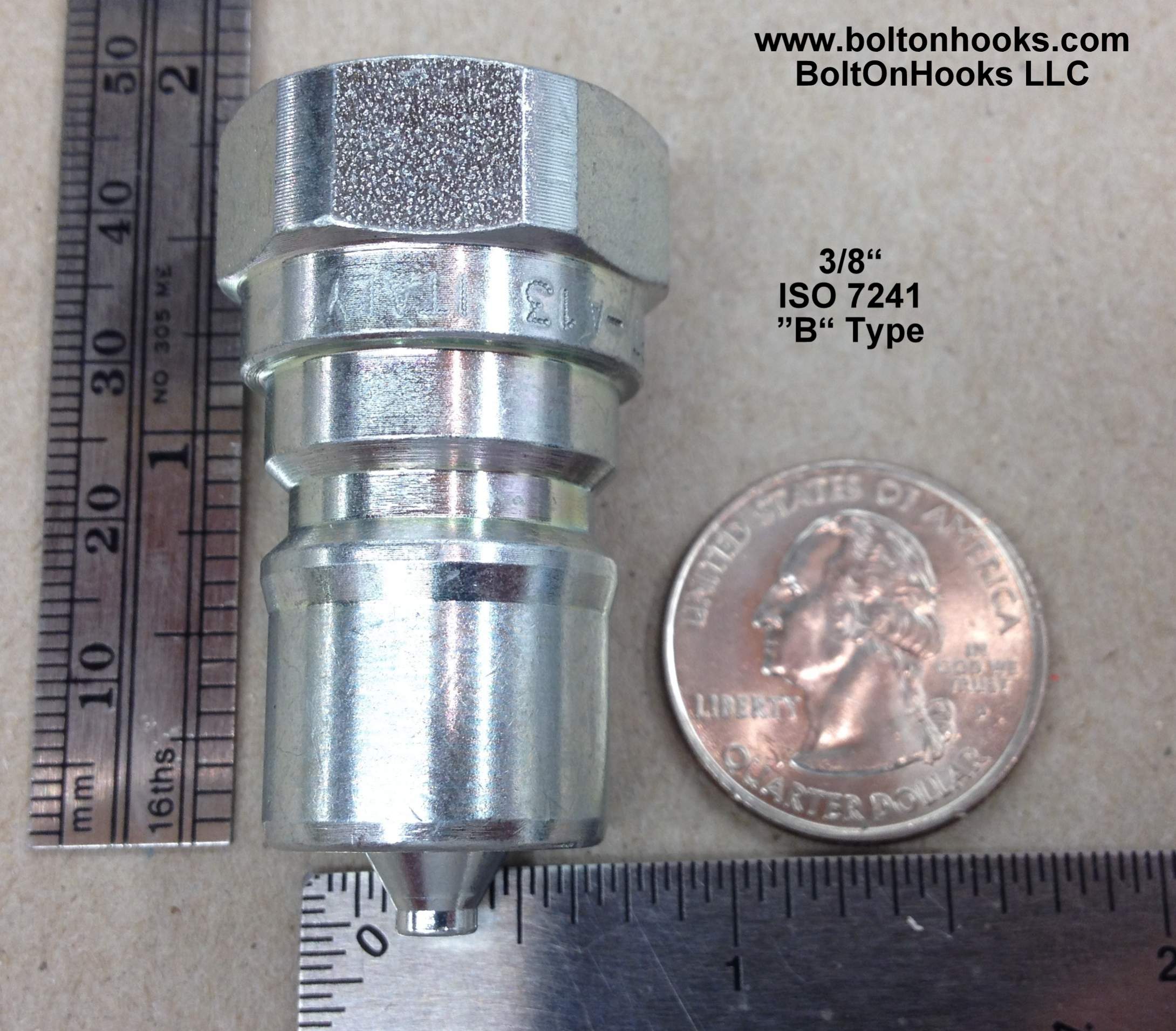

3/8 ag style with 3/8 np thread. NV-38-F is a part number used by my local hydraulic shop.
   / tweak loader hydraulics #9
If you want to match up couplers, take the numbers and manufacturer and visit your local hyd shop or search the Internet for compatible couplers.
Parker, Safeway, Faster, Snaptite, Stucchi, Eaton, Dixon, just a few manufacturers.
