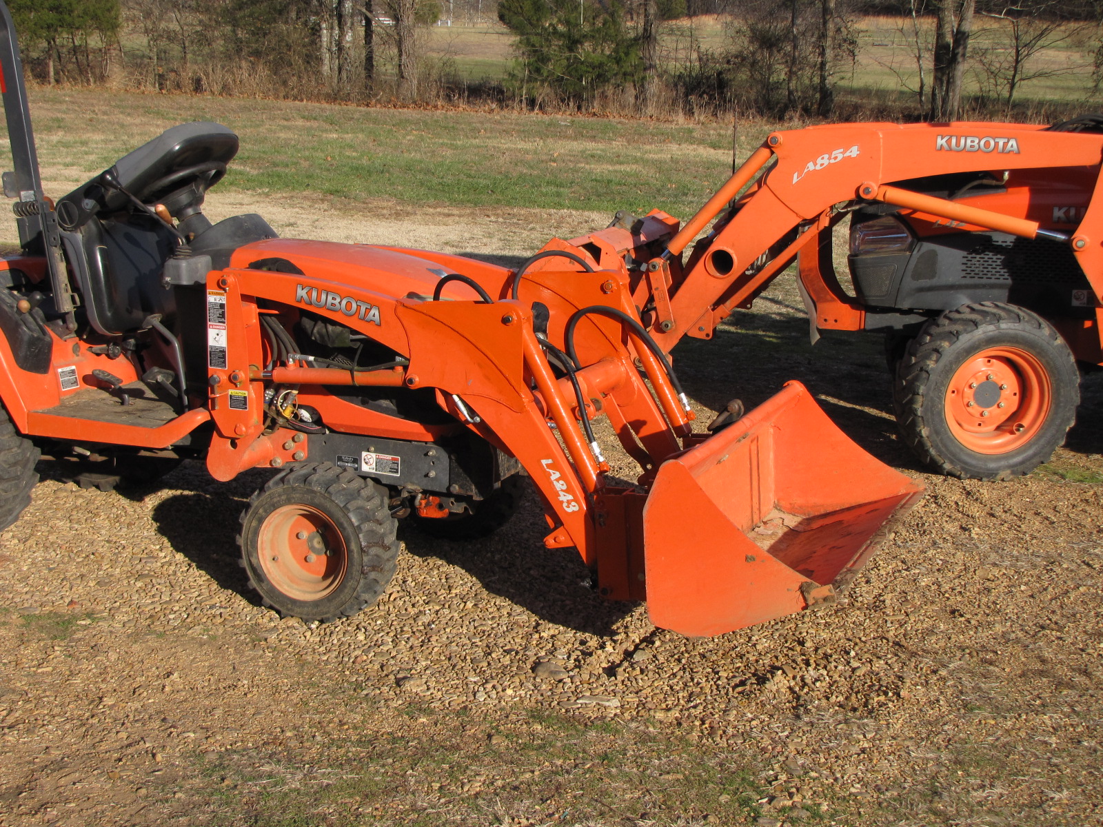

Got a good start putting twin cyls on my BX2660 this week.

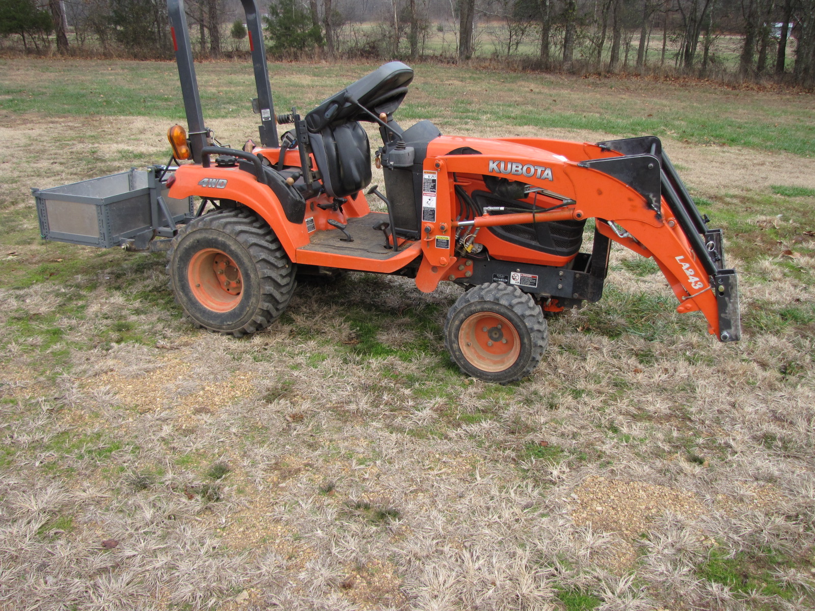

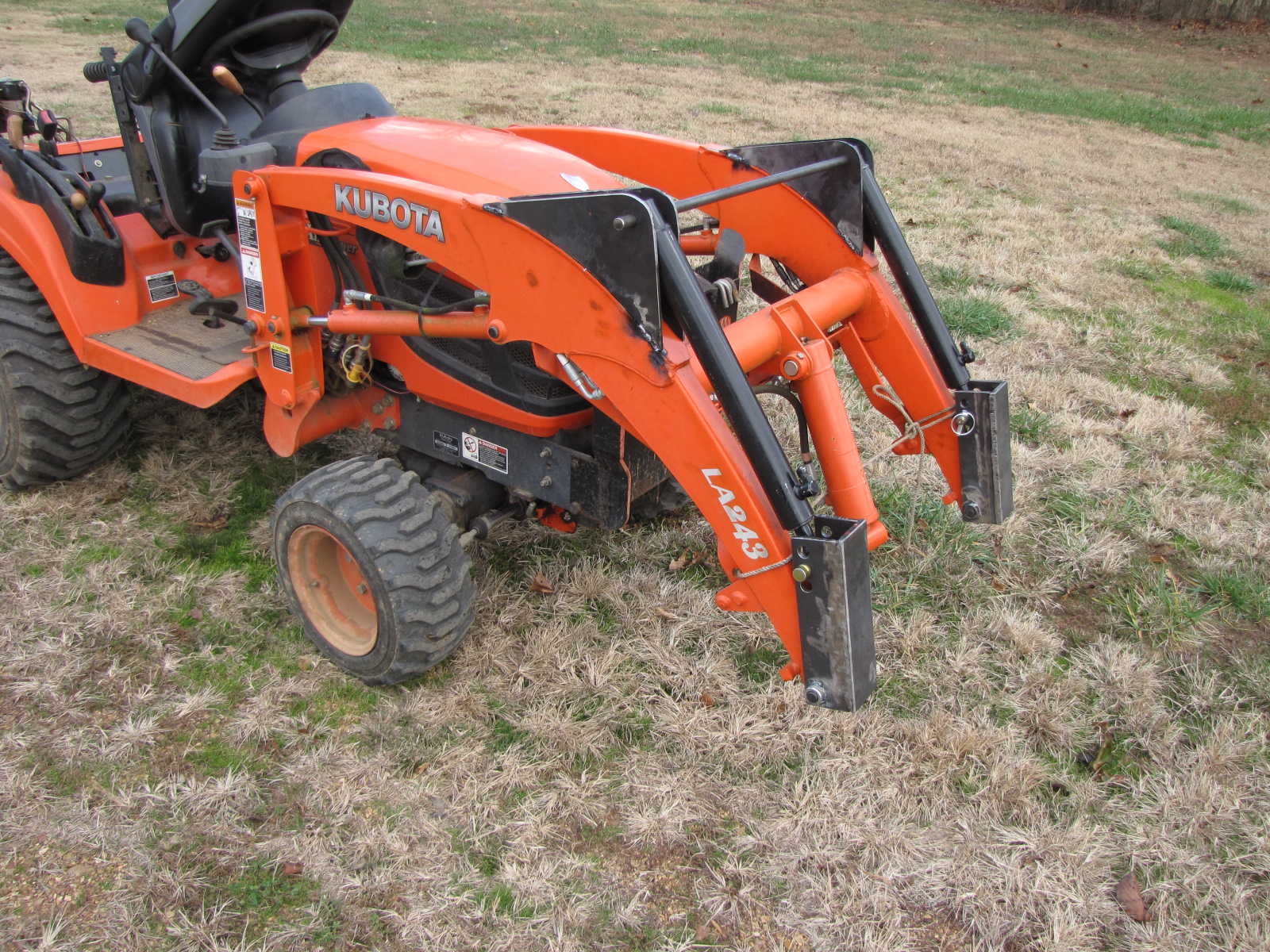

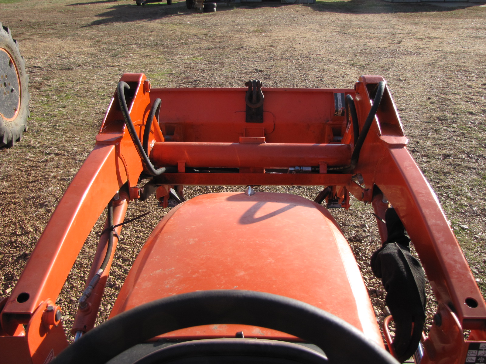

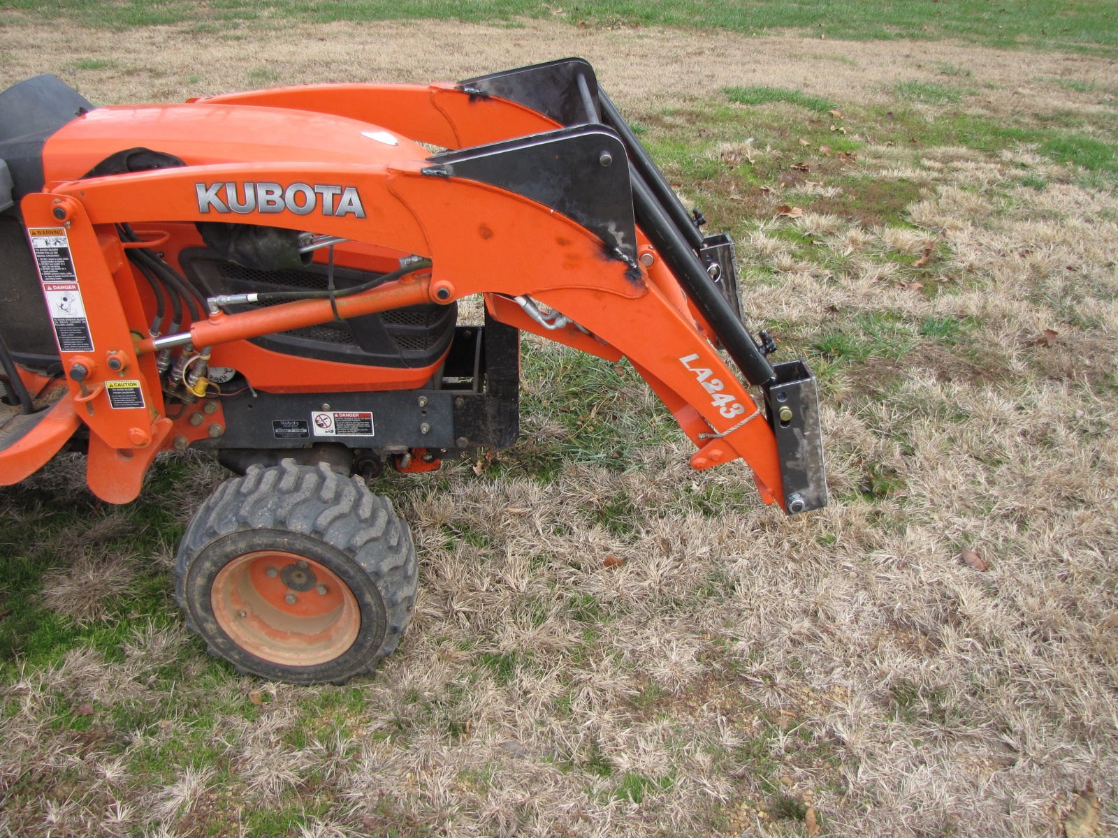

Got it all done today, just some touchup paint and make something to hold my pins. Dump and curl are about the same, might of got a little more curl. Tried it out and now when I tip the bucket edge down it goes down and can pull it back up while still moving fwd. The tip well lift the front up real easy. The brake out force is super, super good. Don't know how much lifting power I lost yet, because of the bucket moving about 4" fwd. I used 3/8" hose because the old cyl used them. I'm going to change to 1/4' and then I can use shorter hoses and well look a little better. The speed is enough that I think 1/4" well not slow it down to much.
