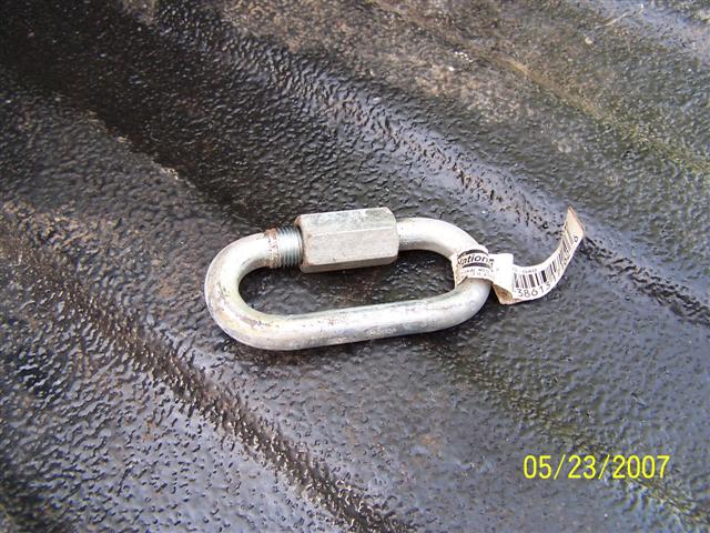

   / Twisted Chains #8
Joe,
Can't you shorten the chains? or get yourself a couple of these to take up the slack. Each is rated for 2640lb.

   / Twisted Chains #9
DieselPower said:
Short answer, yes it does reduce it's load carying capacity. If you need to shroten it you should use a chain shortener. Simply a chain link with a hook on each end.
When I went through Wreckmaster school one of the first thing's they teach you is to make sure your recovery chains never become twisted as it can greatly reduce their working load limit. If the recovery will induce a twist into a chain a swivel should be used. Some rotation of the chain is fine but the links should never fold over each other as you describe.
Hmmm, I would not have thought it would make a difference. Learn something new everyday. Does it reduce the load capacity due to the pull being across the width vs end to end?
jb
   / Twisted Chains
George:
Thanks.
I'm going to see if I can shorten the chains without a lot of work or use the links. I'm getting lazy with old age.
