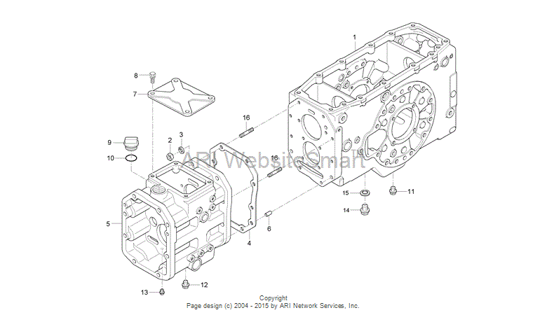

But I do have a question. Does the tranny/hydro have two fill plugs?
When I added some hydro fluid after changing the filter and just figuring that the red plug on the top of the tranny is where you fill it. But, now looking back at the Kioti manual there is one at the back of the tractor too and that's where they said to fill it at. So, did I screw up?
I can't think of anything else that would go in that red plug on top of the tranny except the Hydro/tranny fluid.
I went back looked all through the manual to see what the red plug was for on top of the tranny where I had filled it at. But nowhere is this plug mentioned at all. It does show a pic or two of it but nothing mentioned at all about it. So, I'm confused on this one.

What red plug on top of the transmission? I have never heard of this.. Some Pix would help. But if the fluid filled the transmission reservoir, then I can't see how it would be a problem. On all of the Kioti tractors including mine the fill plug is on the back of the tractor. I have never owned a DS. I see you have met and defeated that dang hydraulic filter gorilla. Congratulations, and welcome to the pack!

I don't own your model, but my 3054 has a plug on the transmission and one on the rear of the differential case which serves as the case vent. You fill from either port, but I've found the transmission fill port to be more user friendly
/ Two plugs for the same thing???? #9
If it's the same as the CK35, the red plug on top (still behind the seat though) is the fill port, the yellow one further down is the dipstick to check the fluid. You have it right:thumbsup:

I found this on Michigan Irons site.... It does appear to show a fill plug on the front of the Trans. My CK20 has the fill on the front of the tranny as well and has a red cap, on the right hand side of the tractor and the level check is on the left hand side (also on the front of the tranny).

Rancho and Patches, it seems like you guys are correct as that is the fill plug I used and yes, it did show to bring it up to specs VIA the sight glass on the side. My DS3510 does not have a dip stick either just the sight glass. Also Rancho, that pic that you included shows the plug just like what I was talking about. I'll tell ya reading this manual sometimes makes no sense at all.
I just filled it from the top because that seemed the obvious place. But this is coming from a guy that got off a old trusty Ford 8N.
