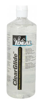

I've used something like below several times by the 5 gal bucket on long runs of big wire. I try to size my conduit where I don't need lube most of the time. On a short run that needs something I have used dish soap many times. It works fine.
