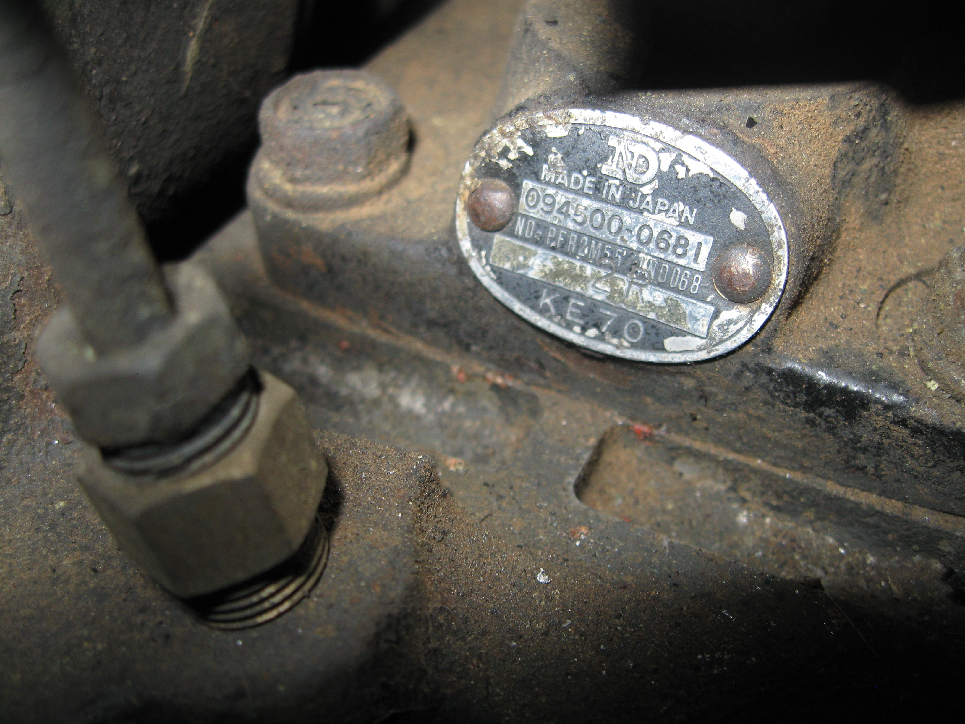

Hi i have a tx1300 with ke70 engine. Which injector (nozzle) is corect and what is the preasure to be set.

   / TX1300 injector nozzle #4
I have the Denso program on my home computer & it matches THE PUMP TO THE INJECTORS..
The EASIEST WAY for me to answer your question is to have the injection pump #..
Just like watt did..
IF your pump # is THE SAME.. the previous info is also..
IF NOT, just post your pump #..
   / TX1300 injector nozzle #5
Oh okay, unfortunatly my pumps are not in as good a condition so the lettering is not quite as clear, I have a spare engine to salvage bits from so here are some picture of both pumps, I will be interested to see if they are interchangable to the injectors, as both engines are K3B but the engine numbers a quite far apart.
Untitled by chrismac2012, on Flickr
thanks for your help, if you cant make out any of the numbers I can have a closer look for you.
thanks Chris
   / TX1300 injector nozzle #6
YOUR noz. # is 093400-0010
Opening pressure is>> 1700-1850 psi

Hi in my country denso is not avaliable. They sad that the foloving are the same:
- monark 39305014 (curently instaled)
- bosch 0434250014
- bosch 9430037212
- bosch 9432610012
I have ordered bosch 0434250014 but i noticed that are made in India and they do not work bether than the old ones.
I have set the pressure 125 bars (1800psi) it those not spray it looks more like when you open tap water.
Is the nozzle incorect or is problem that are made in india and not originale german quality?
   / TX1300 injector nozzle #10
The Bosch 014 noz are a direct cross to the Denso 0010 noz..
"SOME" noz from India, DO NEED to be "reworked" before they will atomize correctly..
Its not uncommon..
Unfortunately, you probably paid more for the Bosch noz than the Denso actually cost.. list price on the Denso noz are $14.00 US/each.
