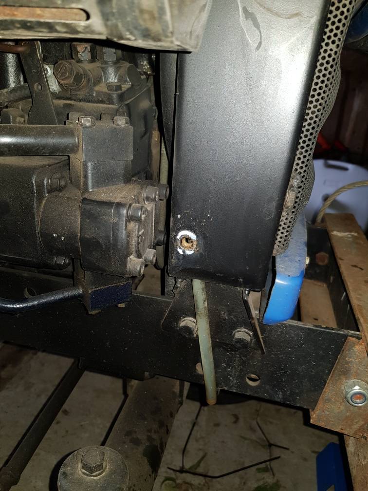

And again, new day, new problem.
Yesterday I changed hydraulics oil on my tx1500. I did it completely, take off differential and gearbox cover, cleaned inside, cleaned filter, put back together and hydraulics were working.
Today using the tiller, after 30 minutes the tiller could not be lifted anymore. Completely dead.
Can it be caused by oil? Here in Poland all they use is this 80/90 type of oil. I went to some special shop to ask, and they assured me it was ok.
Also I have this spare engine lying around. I was thinking to just swap the oilpump out to see if this would fix stuff. But there is this big piece of steel in the way (see image) . Can I just take this out without the tractor falling apart? I checked 2 of my manuals, but cannot find what is supporting it....
Really sorry to keep asking these questions. If I would have known about all these iseki problems I would have gone for Ursus traktor. At least they work... 20191002_160409.jpeg

Unless I'm looking at the picture wrong the big piece of steel appears to be the radiator mount. If you have to remove the steel to gain access to the hydraulic pump you may have to remove the radiator as well. That type hydraulic pump rarely fails - it relies on the meshing of two gears to squeeze the hydraulic oil out under pressure. When my pump on my Mitsubishi tractor has failed it has been the shaft seal on the front of the pump allowing hydraulic oil to bleed into the crankcase overfilling it. I have been using #46 tractor hydraulic oil. 80/90 weight oil seems rather heavy for using in your tractor's hydraulic system, though. If you remove the upper and lower banjo fittings from the pump the only thing holding it will be the four bolts through its body. If you can loosen them you may be able to pull the pump back far enough and turn it slightly to remove it without disturbing the radiator. Clearances do look a bit tight. Note that some of these pumps turn clockwise while others turn counter clockwise. Look for an arrow on the pump body for direction of rotation.

Marcel, I gather you dont have access to the 4 bolts holding the pump on? if so it will come off with out moving the radiator, that bolt hole that can be seen is that what the outer coweling was fixed by, or is that the bonnet hinge? its the 2 lower bolts you can see plus the other 2 on the other side that needs removed to move that part, but the hydraulic pump has little more than 1/2" (13mm) of a drive stub, or it did on my TX2160,
Slacken the small pipe leaving the pump further back somewhere , dont disconnect it just slacken it and you will soon know if your pump is working as if it is the oil will pour out when you start the tracter up, this I know as I had a hydraulic issue for a while and this confirmed my pump was fine,

Well i did a measure, but i cannot remove the pump without taking this steel off.
