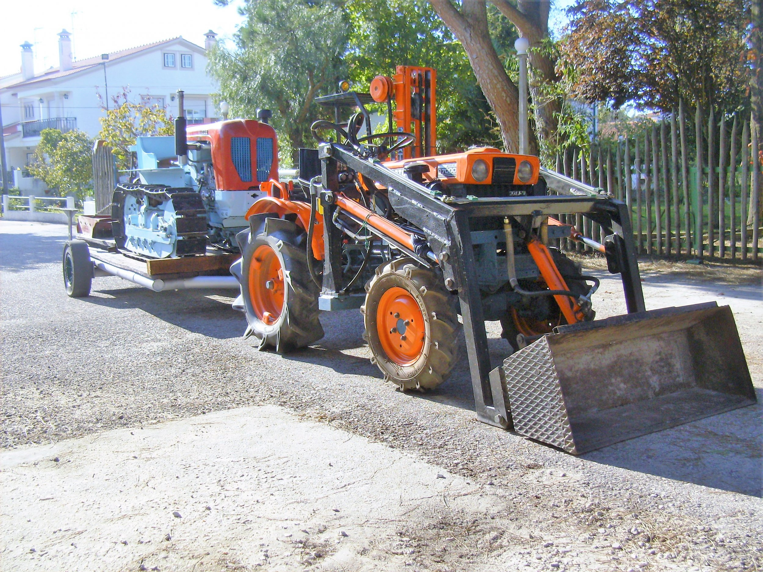

Max towed weight in general is ;
do not tow more than 50% of tractor weight with a trailer without its own brake system, and tow to maximum the weight of your tractor with a trailer with brake system.
BUT what I find very important is the traction you have in the terrain, cause with a tractor you easily feel "allmighty". You've got plenty gears, only the danger lies not in getting up to speed, but what happens when you want to stop or start steering. If you work on the limits of what is reasonable, beware of having your 4wd selected so engine braking on frontwheels works and on slopes be very very carefull a non-brake-trailer might simply push you "out of the way" or pull you sideways cause you might have plenty of traction on your tractor but sideways a heavy trailer might just pull you over... Been there, seen it, done it.
Another risc on slopes is accelerating from standstill with the tractor tilted up on the slope already and the trailer still on flat terrain. It happened even to me with my tow hook below the horizontal height of my rear axel, my tractor started flipping over backwards.
