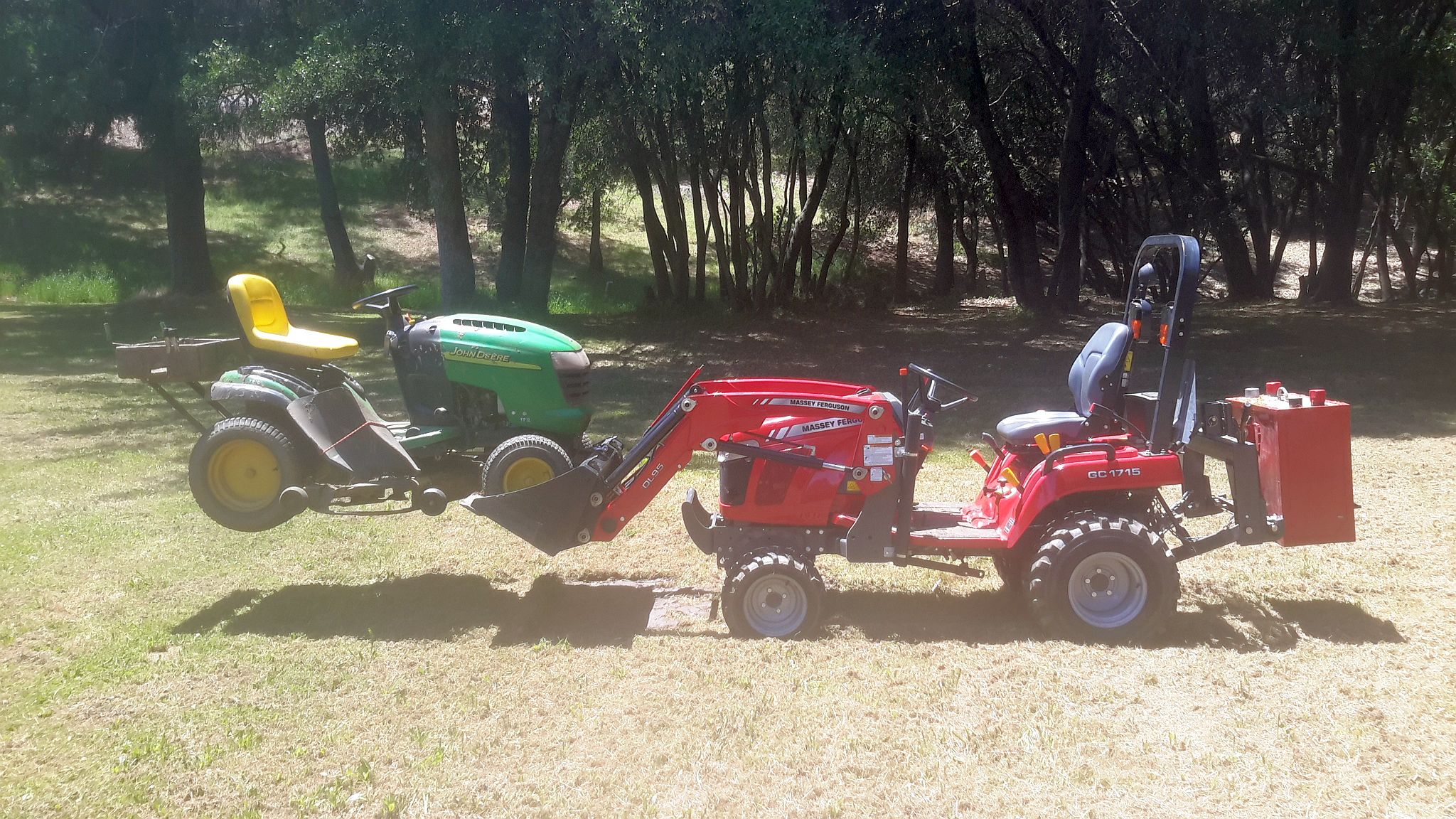

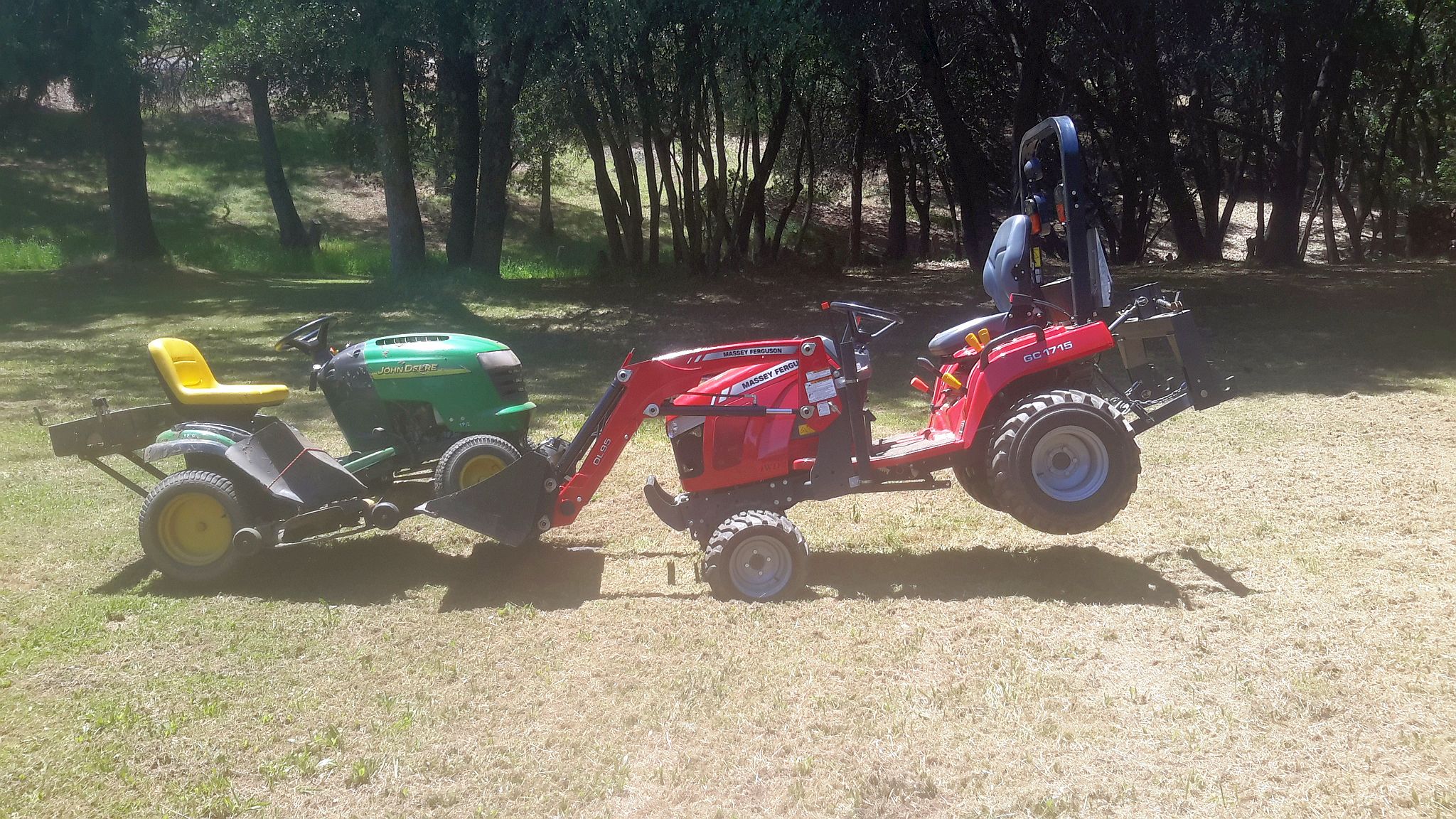

My SCUT (MF GC 1715) weighs in at about 1400 pounds and has lift potential of about 650 pounds lifting force with load in bucket, but found with more than 500 pounds in bucket it can lift rear wheels off ground, my solution was to make about a 500-600 pound ballast box because I didn't want to fill rear tires but I did add 3 inch wheel spacers to make "track" about 6 inch wider, seems to help alot...
Then discovered on some side hill with uneven ground operations with ballast box on rear and with empty bucket the front end becomes light and impedes steering.... Some where in the middle is equilibrium, just have not found it yet..
