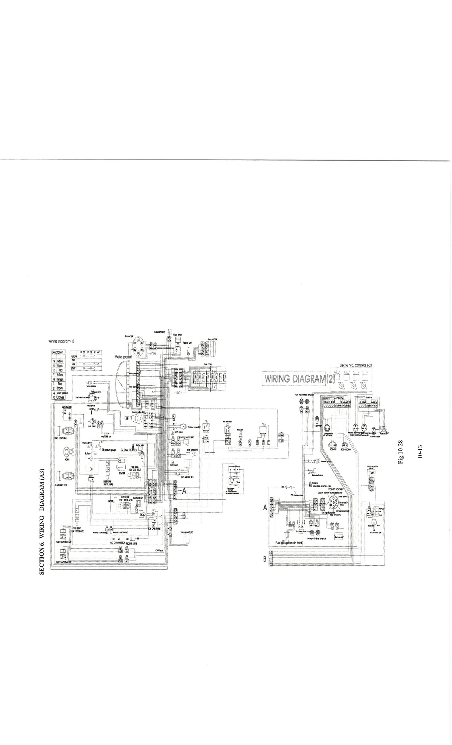

I recently started to work on a T580 with a 2.9 John Deere Powertech Engine. Noticed that my Preheater (Glow Plug) light was not lighting up on the dash traced it back to the Black W/Yellow Stripe Power wire that feeds the Glow Plug Relay to be missing power. According to the service manual I have it is given power by the battery through a fusible link. I have no idea where that fusible link is and I am wondering if anyone has any idea where it is? Also, does anyone know if there is a re-drawn Wiring Diagram anywhere, the one in the service manual is awful to use.
This may be helpful to you.
Dave

Forgot to update this thread, fusible link was by the battery. Glow plug was shorted which caused the fusible link to blow. Crimped a new fusible link in and put a new glow plug in and it has been working since.
