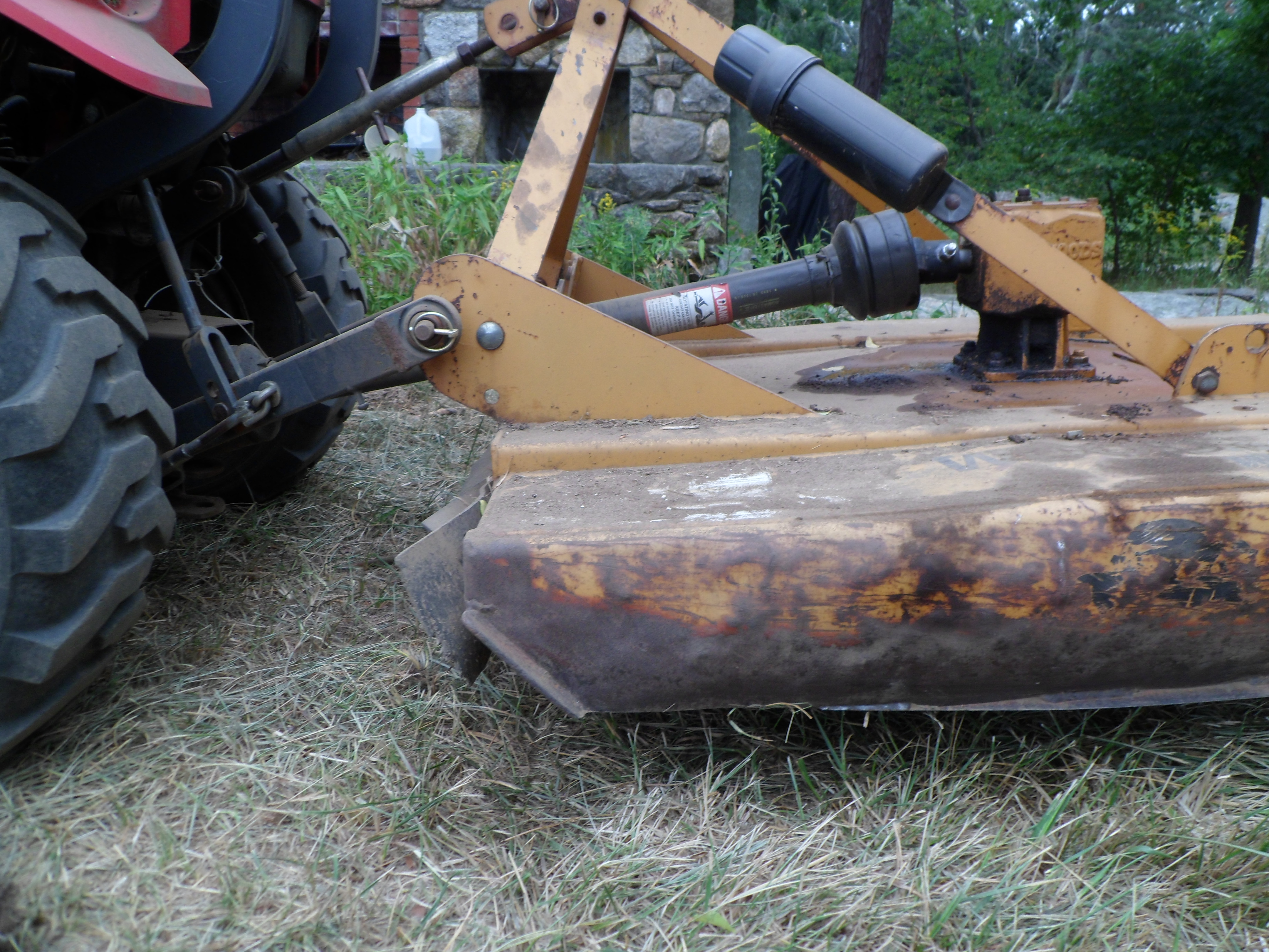

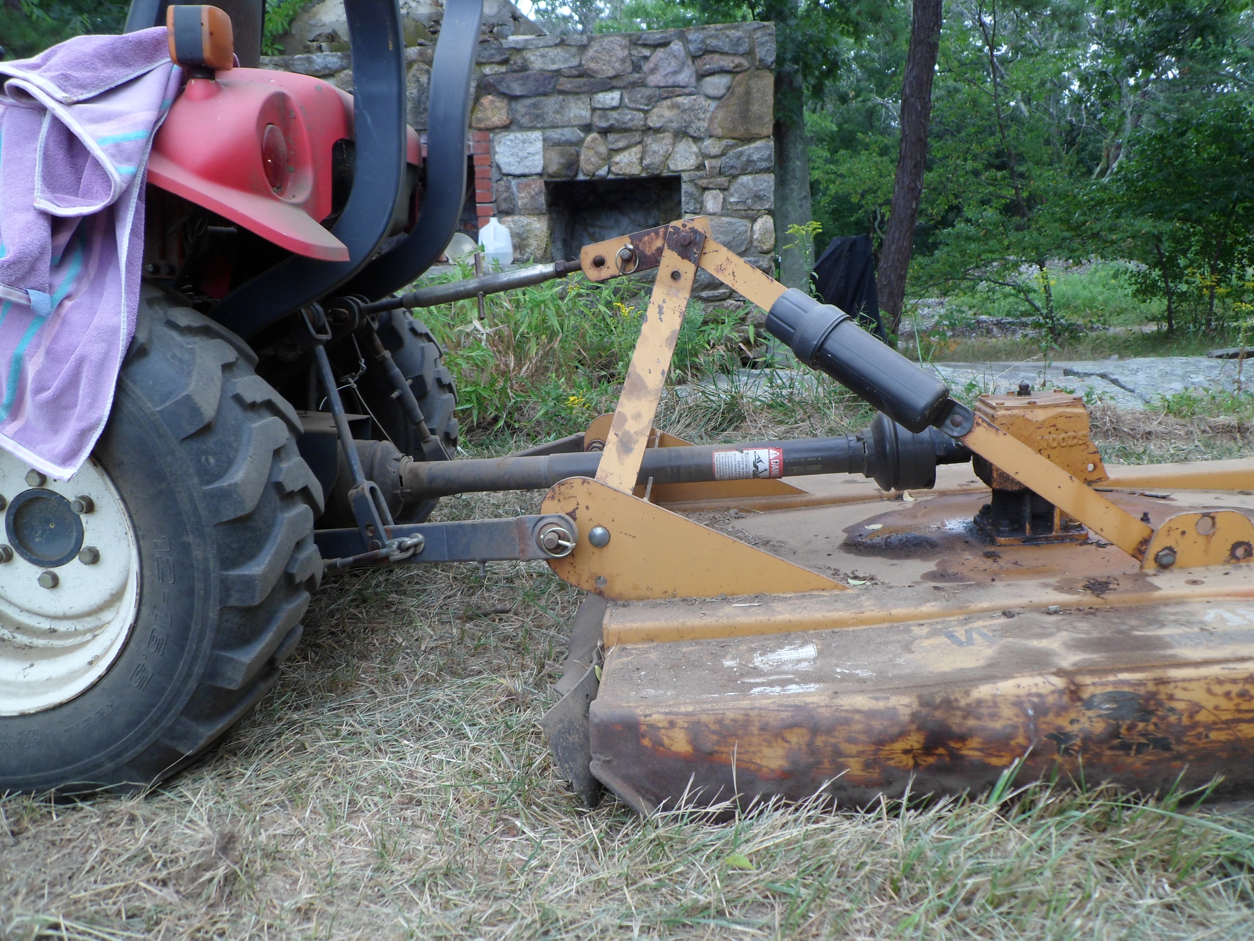

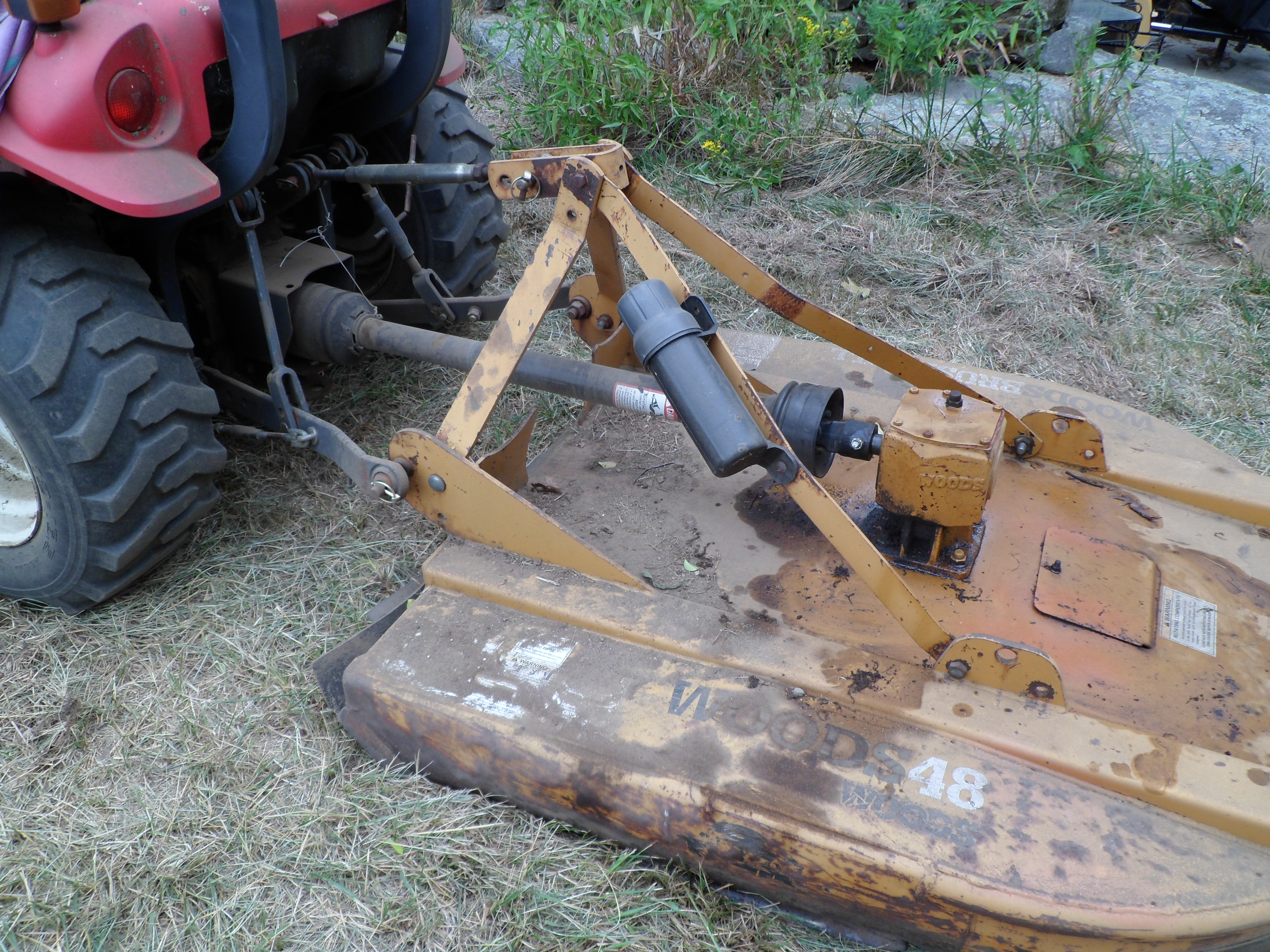

Hi
I have a Woods bb48 rotary brush mower that worked fine with a Mahindra, but now with a TYM273 it only works driving backwards. If I try to drive forward the front of the bb48 digs into the ground.
Thing is I can't see how it can go higher in the front. Where the toplink is mounted on the tractor it is LOWER than either of the holes on the top bracket of the BB48.
Can it be that the BB48 is just plain incompatible with this tractor!??
Chris

Chris, I have a Woods BB60 Cutter and it works just fine with my 273. I fail to understand how come you are having any problems with that 48". Maybe some pictures of it mounted to your 273 might help to figure out the problem. A tractors a tractor, Mahrindra or TYM if you've got the pto power to spin it, you can run it. Greg

I am attaching some photos
It may be the BB48 is just too bashed up
