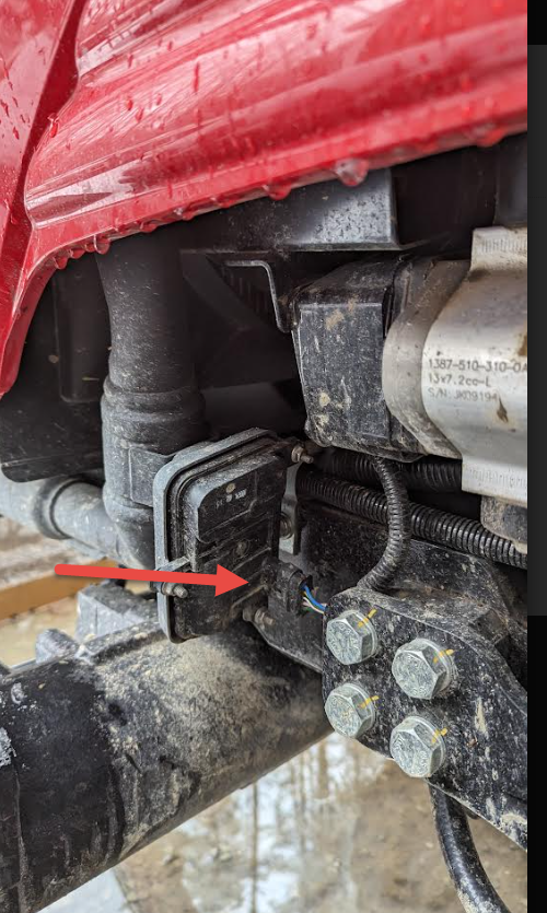

So when you have both of those flashing it means there is a fault with DPF system (nothing about that in manual). Apparently yesterday I caught a stick and it's broke the male end of the connector. Service tech figured it out, I would have never saw it as it was bent over, not completely broke off. He put the female end over the pins and both errors went away. It's in regen now, functioning as it should.

I am having same issue. Both are flashing plus the check engine. What pins are you referring to? I cant get a service tech out for several weeks and need to move feed. Will I loose power or damage it further?

Drivers side of the engine, just up from the front tire. There is a black box with a connector and 4-5 wires sticking out of it. See if that's lose.
MIL seems to have to do with that connector being bent/broken. I somehow got a small tree branch stuck in there and the connector broke lose.
Unfortunately, service told me they had to replace the whole unit. If it's not covered under your warranty it's ....... a lot. (~$1000)
My understanding is that no you will not do damage to it if you run it that way. It just won't know when to regen.
But, I suggest you confirm with service.

That black box is an exhaust valve actuated by a stepper motor and a controller for the motor. This valve is used to increase the temperature of the DPF and therefore complete the regen process. Without that working 100%, there is no way for it to increase the temps enough for the DPF.
