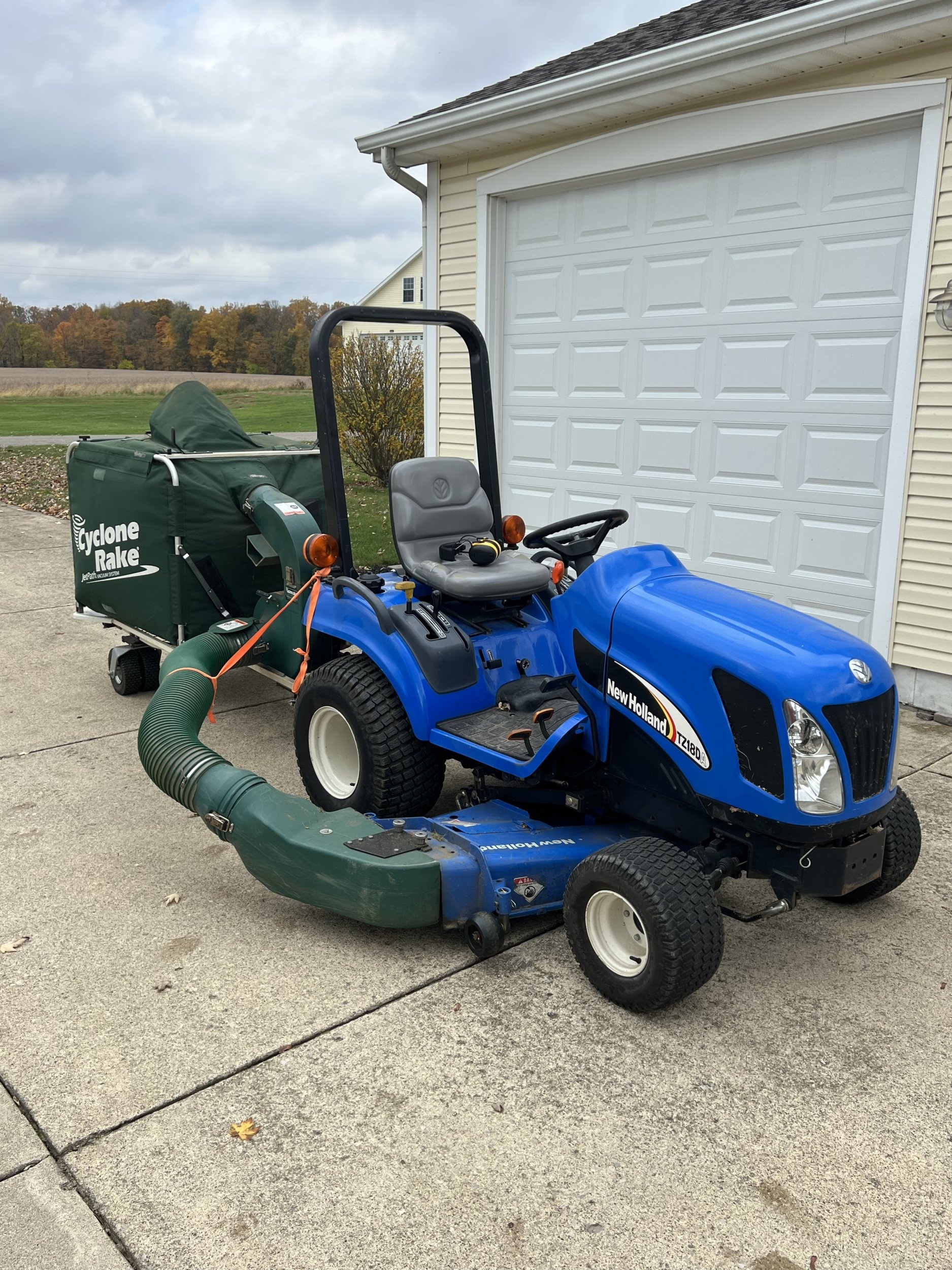

I set the parking brake, put it in neutral and disengage pto but it won’t stay running when I get off.
Is there a bad sensor somewhere, what do I need to check?
Thanks,
Jim
   / TZ18DA Dies When Not in Seat
Try shifting the pto lever to rear only, then dismount.
It worked! Thanks so much, got to be a real hassle checking/emptying the cyclone rake!
Cyclone rake on TZ18DA
