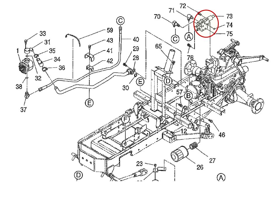

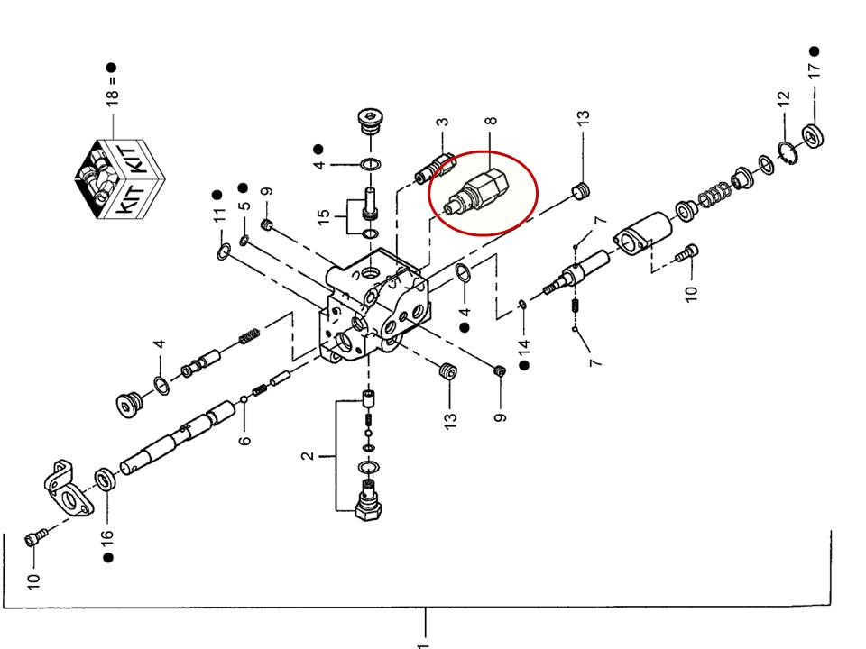

My only input as far as the pressure is concerned is to say you should rev the engine to 2500 rpm to measure pressure. Other than that, here is some help locating your pressure relief valve.

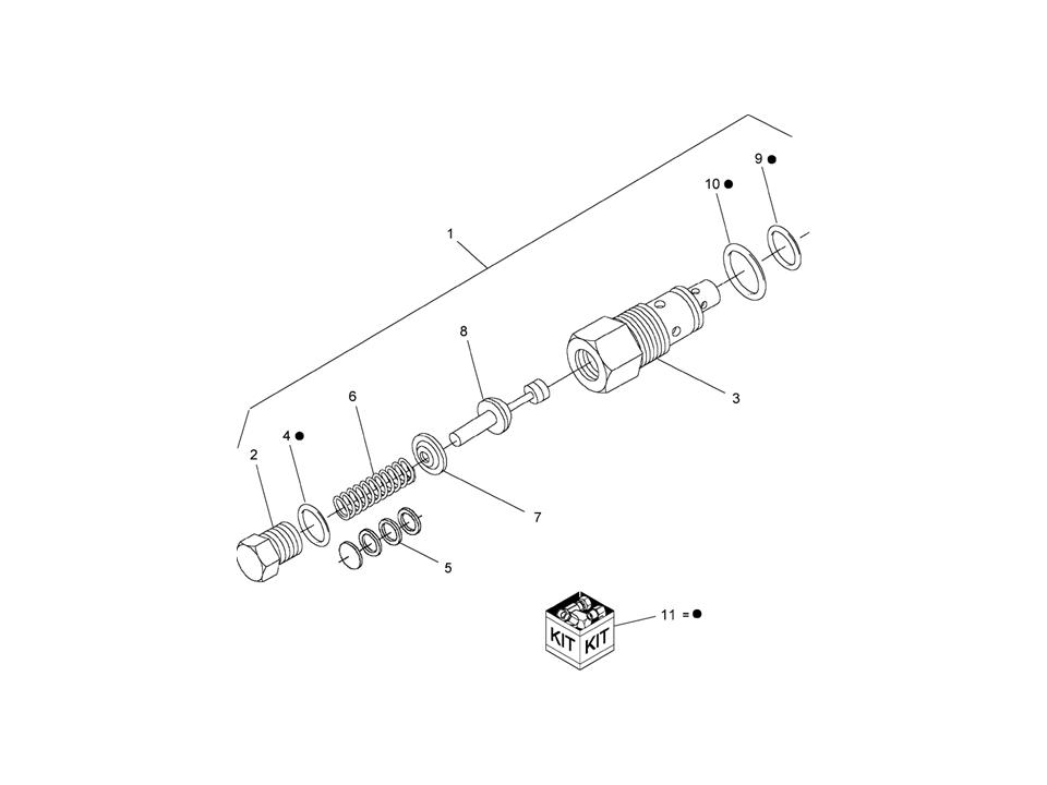

The first diagram is a locator. Item 73 is the control, circled in red. The 2nd diagram is the control with the relief valve shown circled in red. The third diagram is the relief valve with item 5 being the shims that control relief pressure. You can order a shim kit from your New Holland dealer to adjust the pressure carefully to make it in spec.
