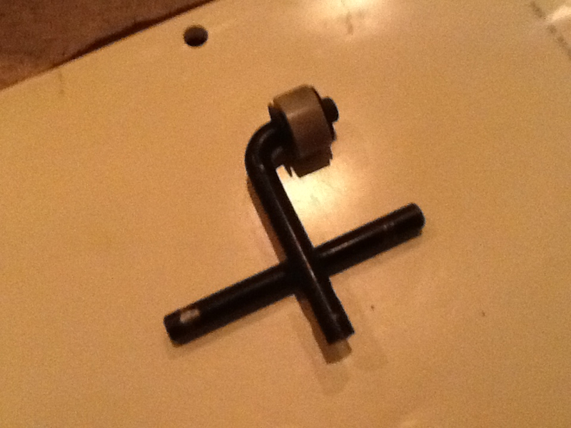

Thanks, I have a mystery part also I need identified ill put a pic up soon.

This is the mystery part????

Not sure what that is. I'll look around a parts diagram. Was this just handed to you or did it fall off the tractor?

It was in the operators manual ring binder hole. I've looked some but can't figure it out. Thank you for your help.

I've looked high and low on parts breakouts from Messicks for this part you showed above. I cannot find anything close. It almost looks like part of a seat slide or something where you could adjust your seat. I'll keep looking when I have a chance. Everything works? All your levers work, seat slides back and forth ok and pedals work fine? This has me stumped. There are no numbers on it or anything?
