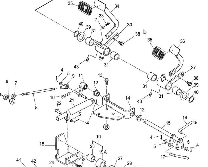

I have a TZ25DA with 125 hrs on it. I like everything about the tractor until I push down on the back up pedal. This thing is a dog backing up, no power or speed, always been this way, I'm just getting more frustrated as time goes on. Is there some kind of adjustment I can make to try and get more out of it while backing up?

Found the problem:D. When I had the mower deck off getting things ready for spring I crawled underneath and looked around. Discovered that the bracket that attaches the linkage to the frame was loose. When I was pushing down on the pedal I was loosing more than half the travel. Apparently it came that way so I didn't know any different. Oh well, I'm happy with the tractor now.

We just fixed my daughter's TZ22A last week, the reverse pedal was completely down. There are 2 bolts that hold the linkage mechanism to the frame. We applied red threadlocker and torqued down the bolts. You have to remove the rubber pad and the cover under it to get to the top of the bolts. Item 14 in the attached .jpg is the bracket.
