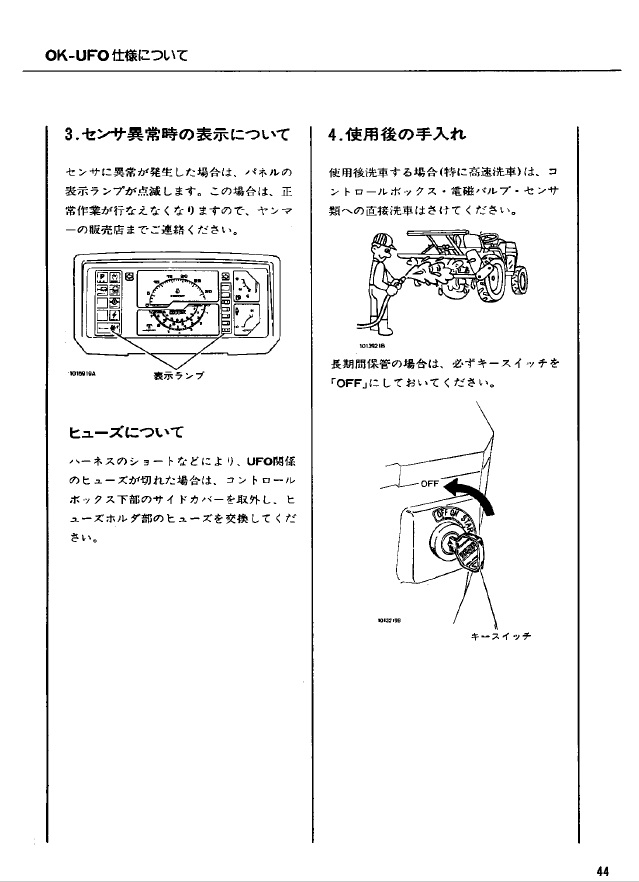

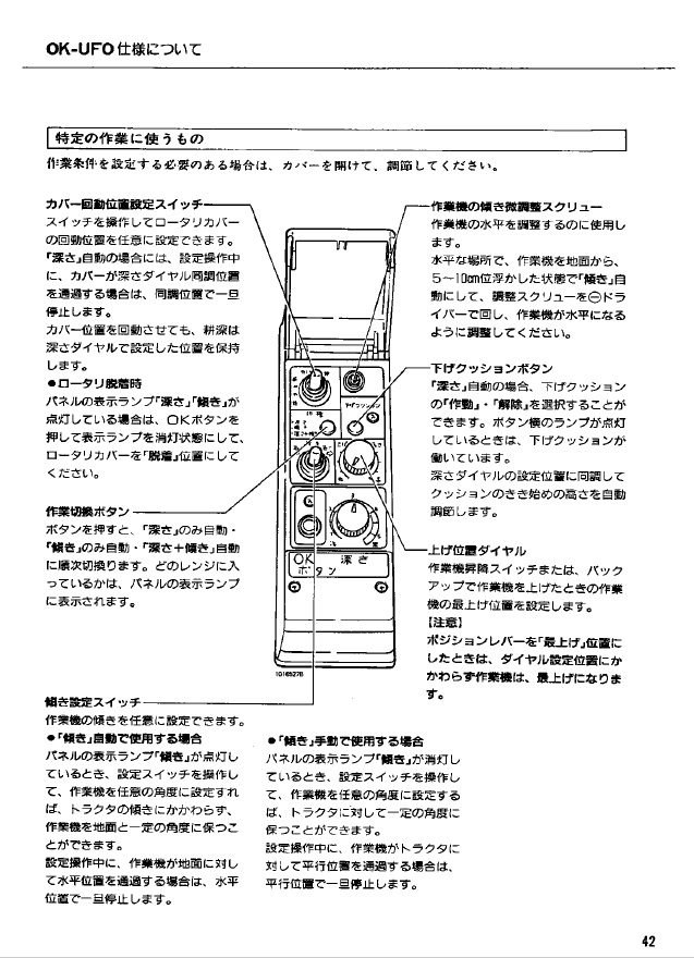

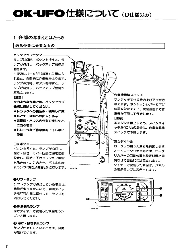

Hi, I'm also looking for a manual or explanation for the UFO :
The only FXxxx manual I found was at Yanmar Japan site, here are the UFO pages out of that manual :
But it's all in japanse so I can't understand it.

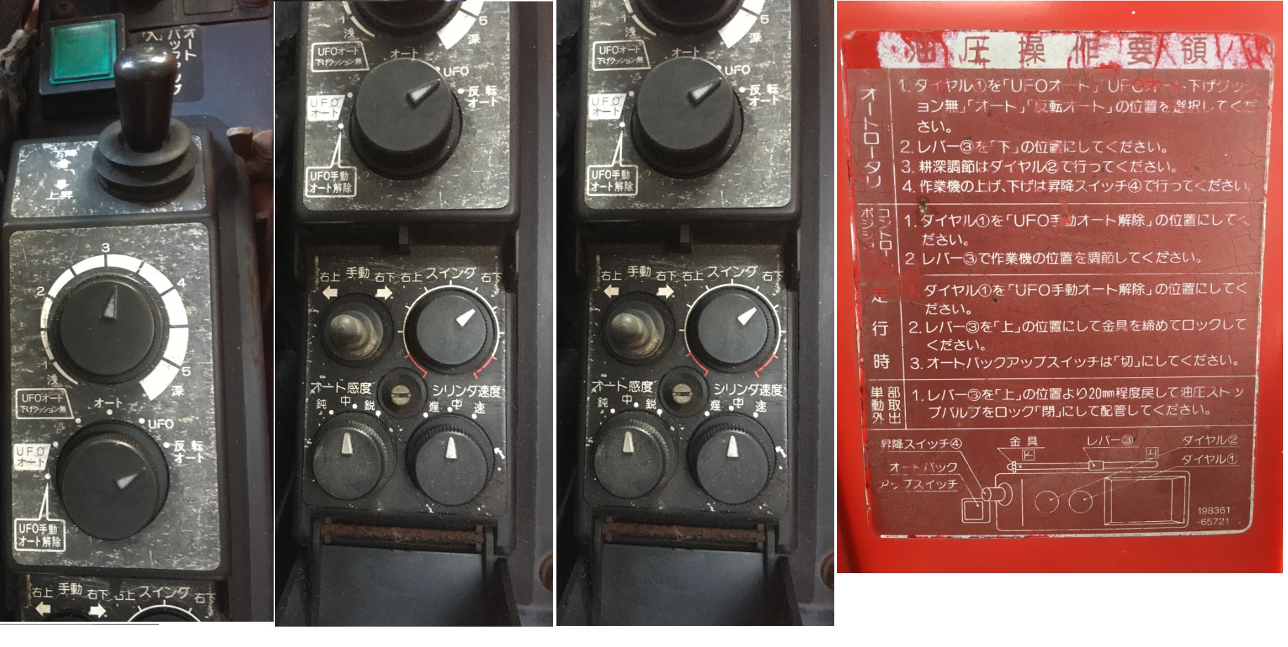

More specific looking for Yanmar UFO manual explaining the use of different selector switches , knobs and settings for :
Hitch drag/draft- and depth - control (arrow 38)
and 2) Lift horizontal Level control (arrow 39)
for an F235 or FX265 or FX435 all equipped with the same UFO selector switches , green pushbutton and knobs.
Picture with numbers 37,38,39 found in the English manual F235D but with NO further explain .
here are some pictures on our FX265 :

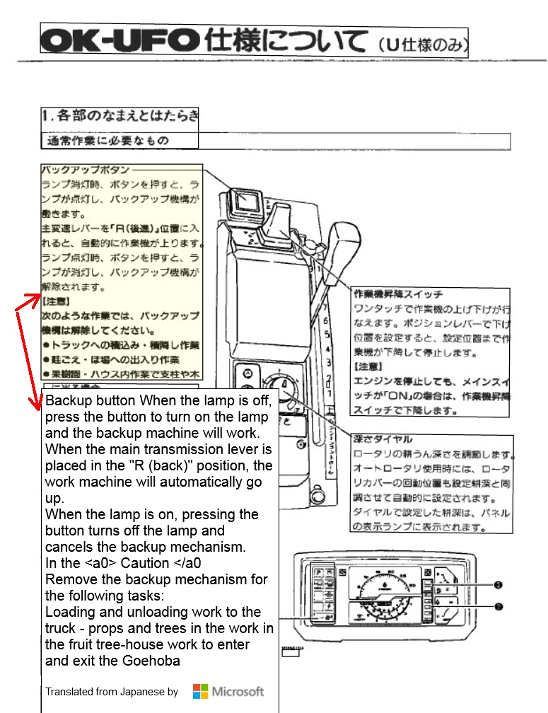

I found this page that will translate it for you. After you select the image and use the language drop down box for Japanese to English it creates sections you can mouse over for the translation.
Translate an image
Hope that helps.

Thx TractorGuy, this translation worked great ! :)
it's the most user friendly OCR/translation site I used already. I'm going to translate to stuff now :)

WOW!
That Bing translation is so much better than the Google translation.
Google gave this cryptic version:
Pack Up Potan
If you press the button when the lamp is off,
The lamp lights up and the pack-up mechanism
work.
Set the main shift lever to r circle (rear road) ”position 1
Then, the work equipment will automatically go up.
When the lamp is lit, press the button to display
The lamp goes off and the backup mechanism power i
It will be released.
[Note]
In the following straws, back up
Shake the mechanism.
• Loading / unloading to the truck L, work
● Ridge • Work to enter and exit the field
● Chestnut garden ・ Supports and trees for work inside the house
Salt that hits
• Do not move the plexus machine such as a trailer up and down
Collection
