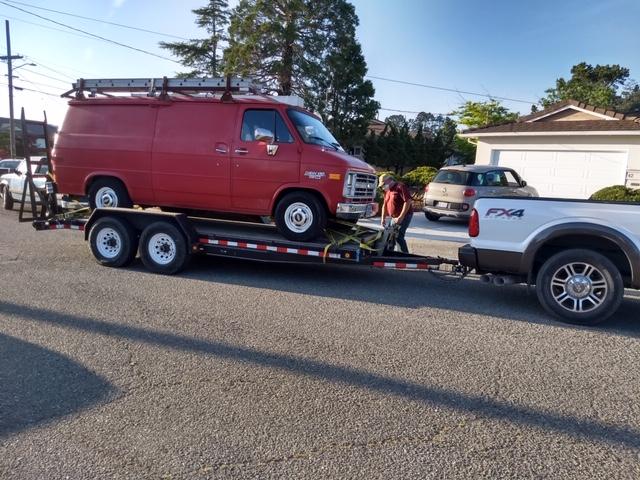

Driving down the freeway and blew a Gates heater hose... Changed hoses and coolant with water pump 4 years back... 75k miles is what I get on a new water pump.
Made a bypass repair and happened to have water so after waiting slowly topped off. Got about three miles with temp maxing...
Shut it down and called auto club... have the Premium 150 mile tow and then learned they would not be able to help... 5.1 miles from home... 40 years and not there when needed... hum???
Called my brother to come with my PJ trailer and loaded up for home.
PJ is 18' and for the Deere 110 TLB... at 18' is always just fits whatever I need with the operative words "Just fits" PJ is 12k downrated to 9980 pounds for CA... the Ford super duty diesel towed no problem even up 28% grade home.
My best guess is stuck thermostat as truck always runs cool and I put in a 4 row heavy duty radiator years ago...
305 V-8 with 4 barrel carb and Automatic G20 van.
Been soaking with PB for more than a week... when bolts snapped I called it a day. Outlet casting is still in place like it is welded on...
I can see where studs would be better in this application and will most will replace with studs.
