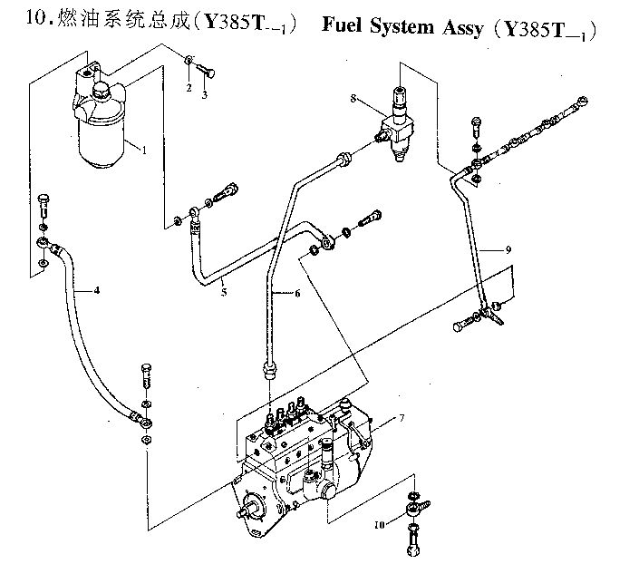

My Mercedes injection pump shares pressurized engine oil too. But these Chinese tractor pumps have their own little sump. I use ISO100 compressor oil in mine. They're a gear-driven all-in-one fuel pump/fuel injector/governor assembly that basically just hangs off the side of the engine block
//greg//

   / ULSD in 2007 chinese diesels #9
Great diagram! That looks just like a Bosch in-line pump!
I doubt you'll have anything to worry about with those pumps, it's definitely ine in-line. I don't know the differences between the compressor oil and engine oil, but I'd be inclined to believe the engine oil would be better for the pump.

Ron, great pics of the pump!! The Bosch pumps are very similar. Do you work on the pumps on your shop? I agree, the engine oil is designed for use in the pumps, it's got all the additives and everything needed to care for the pump. The big diesels have been doing it for many years.
