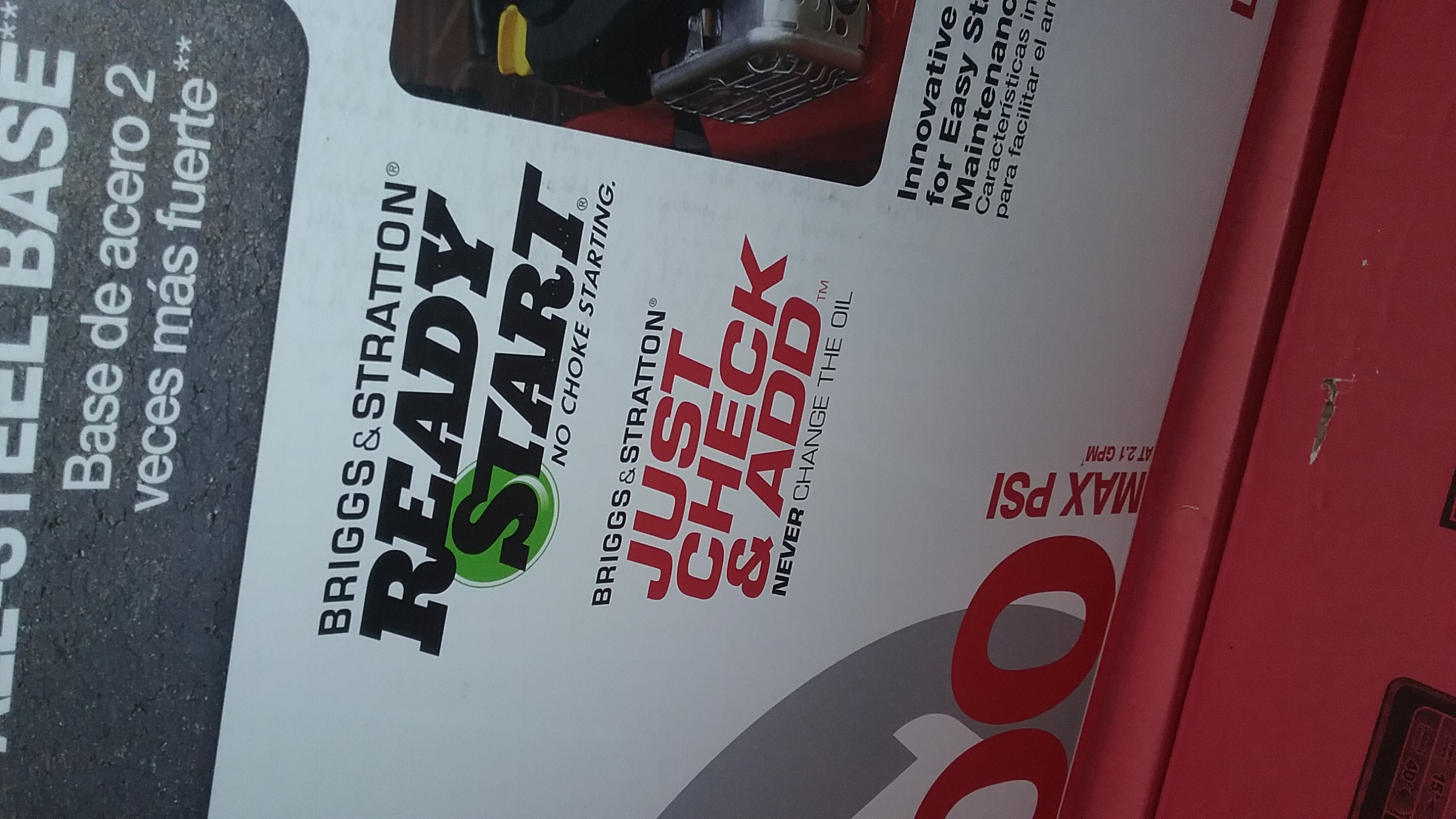

Sounds to good to believe. :confused3:
   / Um what?...Never change the oil? #3
Something else will probably break before the oil filters completely clog.
Regardless, it'll be junk before long...

the science behind it is, from the add mark to the full mark replaces 20% of the oil volume, and that is sufficient to replenish the additive package in the oil, coupled with the fact that most people don't change their oil on a regular bases, if at all. The engine is rated for 125 hours of operation which for the average person equates to like 10-12 years of operation.
The catch is the spark plug and air filter have to be serviced on a regular basis to prevent oil contamination. The problem is the people that don't change their oil, also don't service the air cleaner or spark plug.

Participating here means you likely work on your own equipment and value it being in proper running order. For many people, though, and that includes my father-in-law that had four "dead" mowers in the back yard when I met him maintaining equipment falls out of their aptitude and interest. They may only be acknowledging the practice of many. If you don't overheat the oil and the fill oil is additive-rich it probably doesn't much matter.

Gas pressure washers tend to contaminate the sump with water.
Aside from the usual reasons to change, you obviously want the water out.
The upside is the consumer may never have to add any oil, as they automatically get Make Up Water !
Keeps factories running, somewhere on the planet....
Rgds, D.
They may get water contamination, but I can guarantee the water isn't coming from the pump, unless the owner is spraying the water on the engine and pump. That water directly from the pump would have to cross a seal, a weep hole, another seal, pump oil, another seal, another weep hole and another seal to get into the engine.
