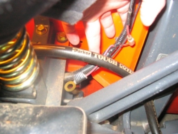

I have a 7610 and would like to add ROPS lights. I have read that some tractors have an extra 12 V source under the seat. I have not been able to locate it, could someone direct me to it ? Thank You

I found the connector on my B2710, under the seat, slightly to the right side, and taped to a taillight wire so that the connector didn't show. So I'll suggest tracing your taillight wires from the light back and see if you find an extra wire taped to one of them.

A pic of under the seat on my B7610.
Red wire with a black stripe coming off of the directional (right hand side) with an eye on the end.

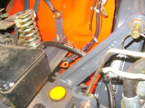

Another pic zoomed out view.
The hyd hose in front is for the hoe.
