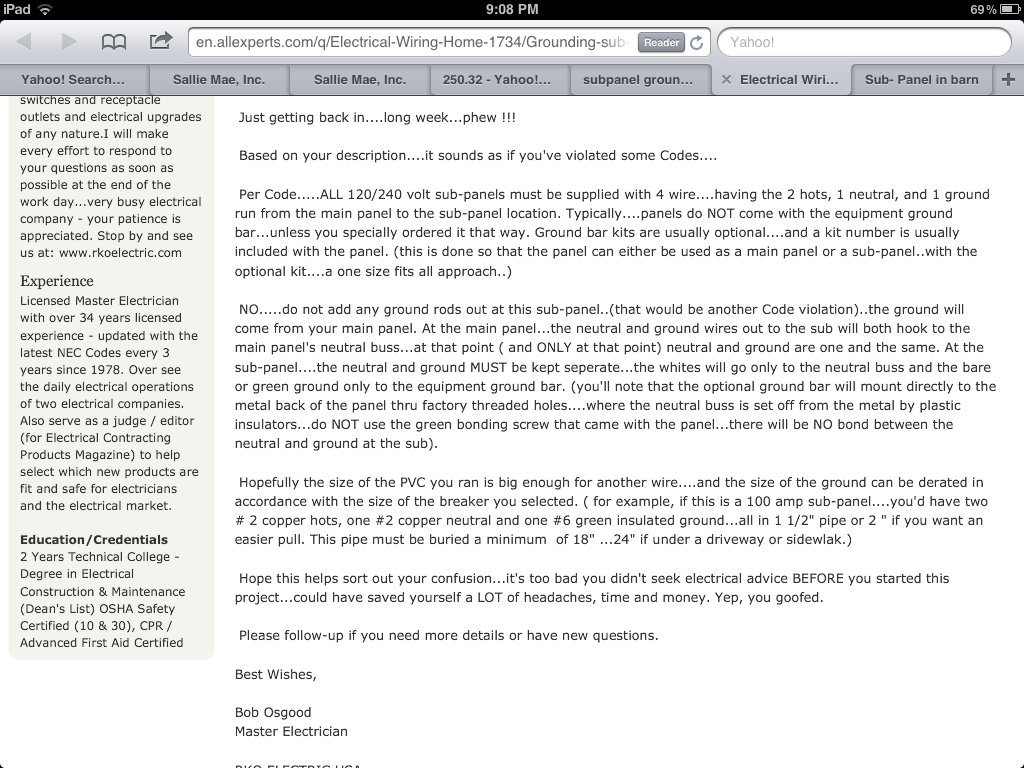

I am running underground 2x2x2x4 al underground cable 85 ft from my cabin to my pole barn. I am going to come out of my panel in cabin with 60 amp breaker and go to sub panel in pole barn to a 50amp breaker. I will be using a separate ground bar in the sub panel to separate neutral and ground. Do I need to run 2 ground rods with loop of #4 copper?? Should the metal barn be bonded to the ground? Thanks for your help. Just trying to get all the stuff in before the concrete is poured.

It has wood posts and just the building tin. See pic as why I am confused. Every electrician tells me something different. Thanks again for your inputs...........

The wire size is fine. Separating the ground and neutral is required, as are two ground rods spaced at least 6 feet apart. It sure would be a good idea to bond the metal to the grounding electrode system.

I have 2 ground rods 6 ft apart at the cabin. I have the separate buss at the sub panel and that is where I am getting different opinions of running ground rods off of this also.
   / Underground elictric to Pole barn #8
You for sure need two ground rods at the pole shed, I know this is in the national electrical code. Unless your state exempts this you need it. Contact a local or state inspector....
