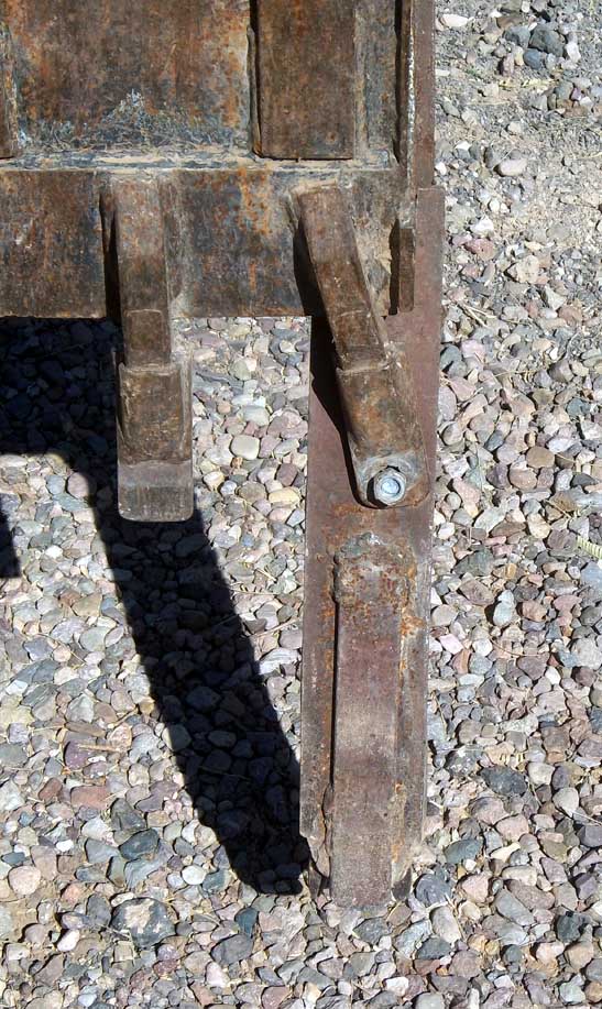

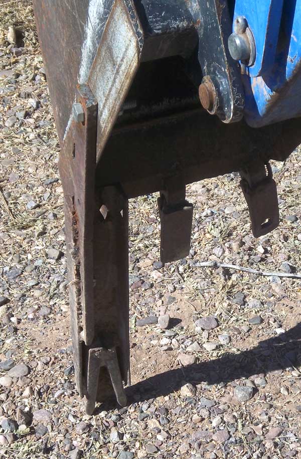

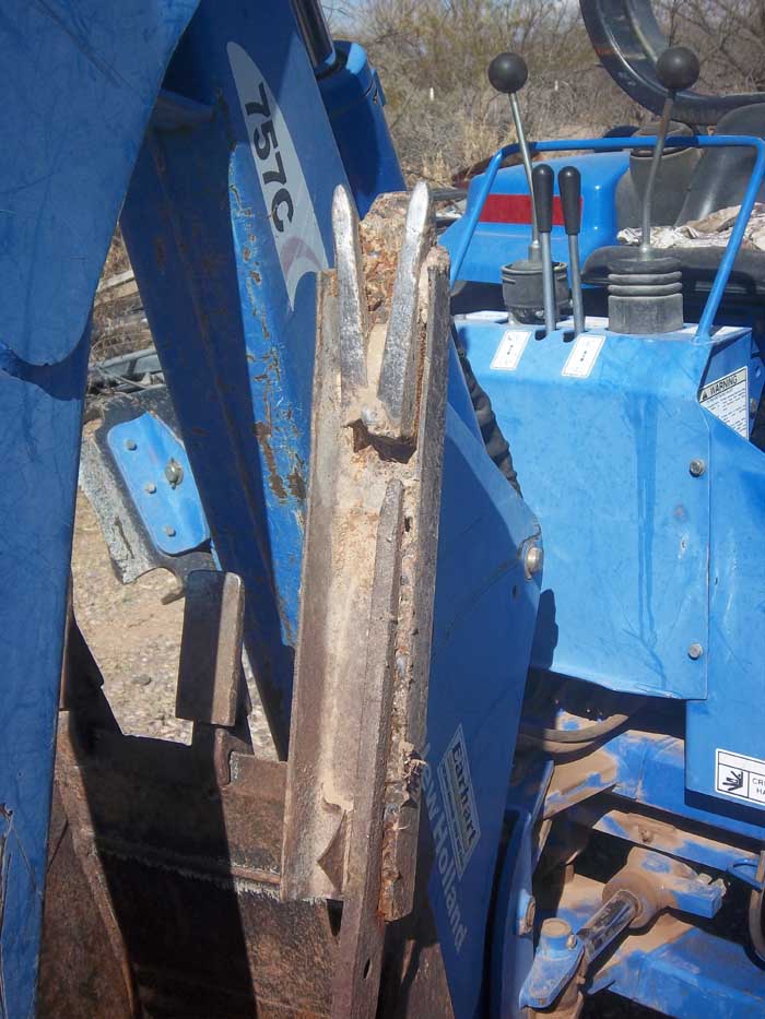

For digging a trench in rocky soil a "pickle fork" will do a fine job. The one shown only digs about a foot deep. Plan to build another 1 that goes down 2 feet. It will also have a baffle plate that moves dirt off to the side. The little guy shown has dug several hundred feet and was first used in an area where there is more rock than dirt.

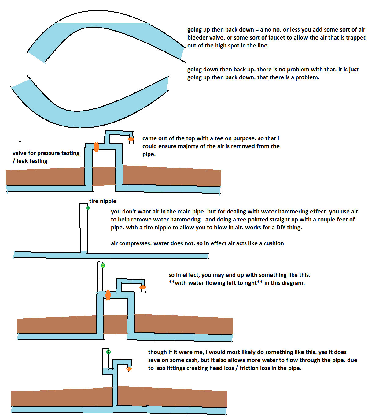

you have a couple things to deal with. you noted "hilly" and you also wanted to make it easier pressure testing the line initially and down the road for leaks.
the "hilly" ground. were the pipe goes up then back down (like an upside down U) you will most likely need to provide an "air bleeder valve, or a watering spigot/faucet. in the highest point of the upside down U's in the pipe run to remove trapped air.
the pressure testing thing. about all i could suggest if it was really that important to test the pipe line sections down the road. would be at the end of each 500 feet. would be come up and out of the ground. for both pipe ends. using galvanized pipe and put yourself a valve. along with an air bleeder or water spigot. so you can bleed out air.
if ya have not caught on. air being in the main hose run can be a major problem. air can form in a pipe run just from regular use. or water just setting in the pipe. it does not require you to have a leak. and needing to air bleed air may be one of them things you do every so often to hardly ever. exception on maintenance / repairs.
my other concern is ""water hammering"" think of water hammer like a truck/car/tractor slamming into hill to stop. for water, water slams into 90's and inside of the pipe and fittings. when it does this the force has to go some place. for truck/car/tractor it would mean dents and things being broken. for water it means pipes and fittings getting cracked. for older homes, folks tend to remember the rattling of pipes in the house. ((this would be ""water hammering"" you can buy "water hammering devices" for homes. that are fairly small and help. or you can build your own. though they can be bigger when DIY.
if ya notice shaking of the water spigot when ya shut the valve down. then ya most likely experiencing "water hammering"
my other concern is if you end up using a bunch of water say at the very end of this 2800' say for washing down a tractor. or something odd ball. you may get a lot of water pressure right off the get go. but after say 5 to 15 minutes running the water. your pressure may start to drop off rapidly, along with amount of water you end up getting. and it could come down to a slow trickle.
if ya look at attach picture and the bottom last 2 diagrams. there be a partial reason for going with very bottom diagram. and that is to help reduce headloss / friction loss. so you might have a couple extra minutes of higher pressure and amount of water initially at the end of the 2800 feet. ((i say a couple minutes but that is only a guess, without knowing specifics. ))
specifics would be. how much water GPH (gallons per hour) or GPM (gallons per minute) or how much water usage daily at each water spigot and fittings and distance between everything. and details on pump, and wanted pressure in the pipe run.

At each 500' section, I was planning to put a tee coming out of the ground with a backflow preventer, hose bib, and then a float valve for a water tank.
   / Underground PE Pipe Installation - Proper Steps? #6
seeing you are in texas. you most likely have to deal with evaperation.
i would suggest adding a ball valve, so you have tee-> ball valve -> check valve -> hose bib -> float valve.
having a union between ball valve and check valve. so you can easily replace check valve. can save you headaches in a few years. when check valve needs to be replaced. that or make sure you have enough pipe. that you can cut off and put a regular coupler in place. **been there done that** of not enough room to easily replace check valve.
