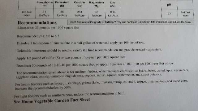

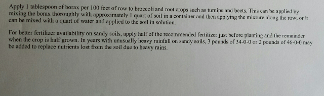

Ok well evidently the soil sample they emailed wasn't complete because I got the paper copy in the mail today. I took a picture of the information on it and I'll upload it. Hopefully it will be readable. It tells me to add zinc sulfate, sulfur or gypsum, 10-10-10, and lime. I'm not sure where to get the zinc sulfate and sulfur or gypsum. Guess I'll have to check with my feed store and see what they have. Just a quick Internet search it seems like the zinc comes in 50lb bags. I don't need but like 9 or 10 tablespoons though. I measured the garden this afternoon and it's only 30x30 or 900 square feet. Is there some kind of other fertilizer or something I could get that would have all this in it or what?

Picked up everything except the lime today. Feed store was out, but going to pick some up tomorrow somewhere else. I'm going to spread it all out probably Saturday and plant some cucumbers, yellow squash and some zucchini.
Now the question I have is after I put down the lime, fertilizer, and sulfur should I go ahead and run the Harrow over it again or leave it and go ahead and plant my seeds?
Also it says to dissolve 1 tbs zinc sulfate in a gallon of water and apply per 100 feet of row. I'm a little confused on that. Do I just spray the sulfur water on the rows after I plant or spray the whole garden then harrow or just spray it after I run the harrow and then plant? My garden is only 1000 sqft.
Should I also pick up some cow manure and put down and harrow in too?
   / Understandang soil sample results. #10
Since you have a small area, incorporate your lime first, then add your fertilizer and incorporate that just before you start planting. Lime can react with the fertilizer and you can lose much of your nitrogen especially if you use pulverized lime. Ag lime is courser and breaks down slower over time. I would wait until fall to add manure. Being vegetables, and depending on age and bedding material in the manure, it could cause problems (microbe types use up the nutrients breaking down the manure and bedding especially sawdust bedding) with your plants and vegetable formation. Good luck.
