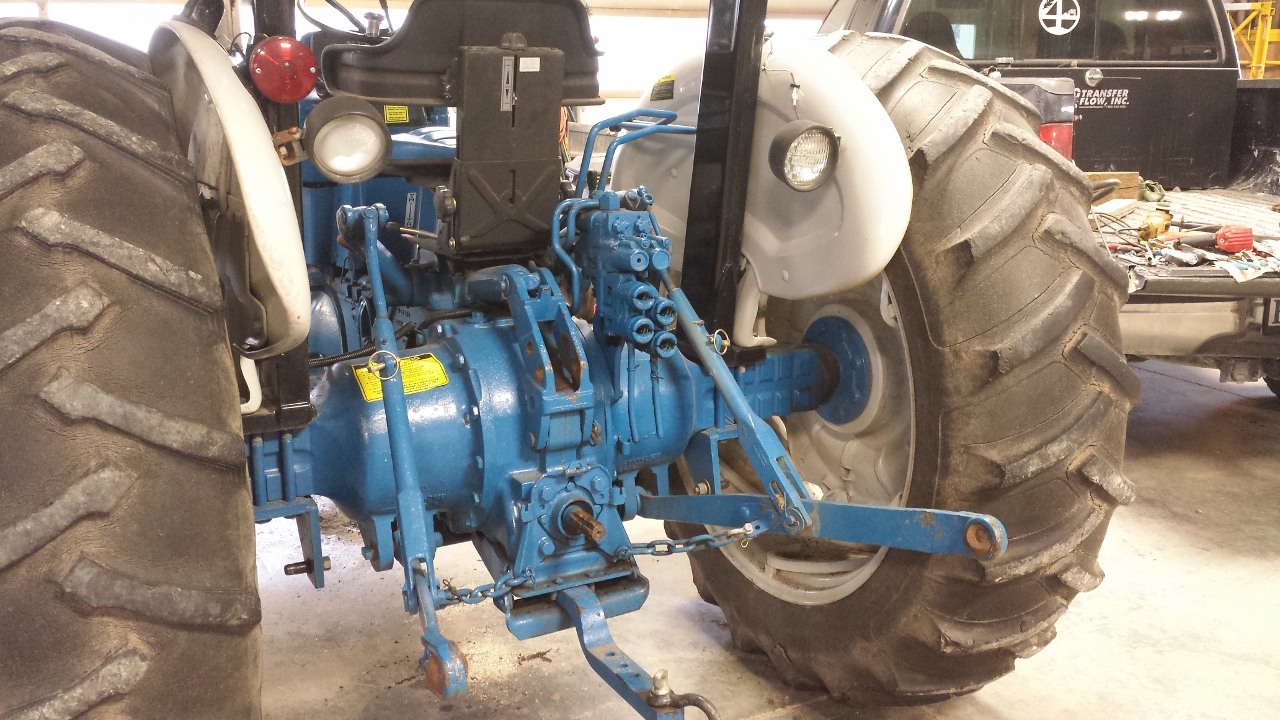

I've attached a picture of my Ford's toplink setup. The top end of the bracket is fastened to the draft sensor, which is adjustable by taking it apart. The lower pins can be moved to increase/decrease the sensitivity of the draft control. Maybe your tractor is lacking this bracket or something similar??
With no markings how did you figure out which lever is the draft lever?
Maybe shoot some pictures and post them?

I guess I just have not been around draft control tractors, odd as that might seem. Right from ford 800/900 to ag tractors. I guess the question is, if that draft sensor is not hooked up, should the lift still work? My guess is yes because you can usually lift the lift arms without an implement on them.
Yes, no doubt the bracket that couples the rigid top link mount to the sensor mount is missing. what I have now is a top link that is just connected to the rigid mount.
