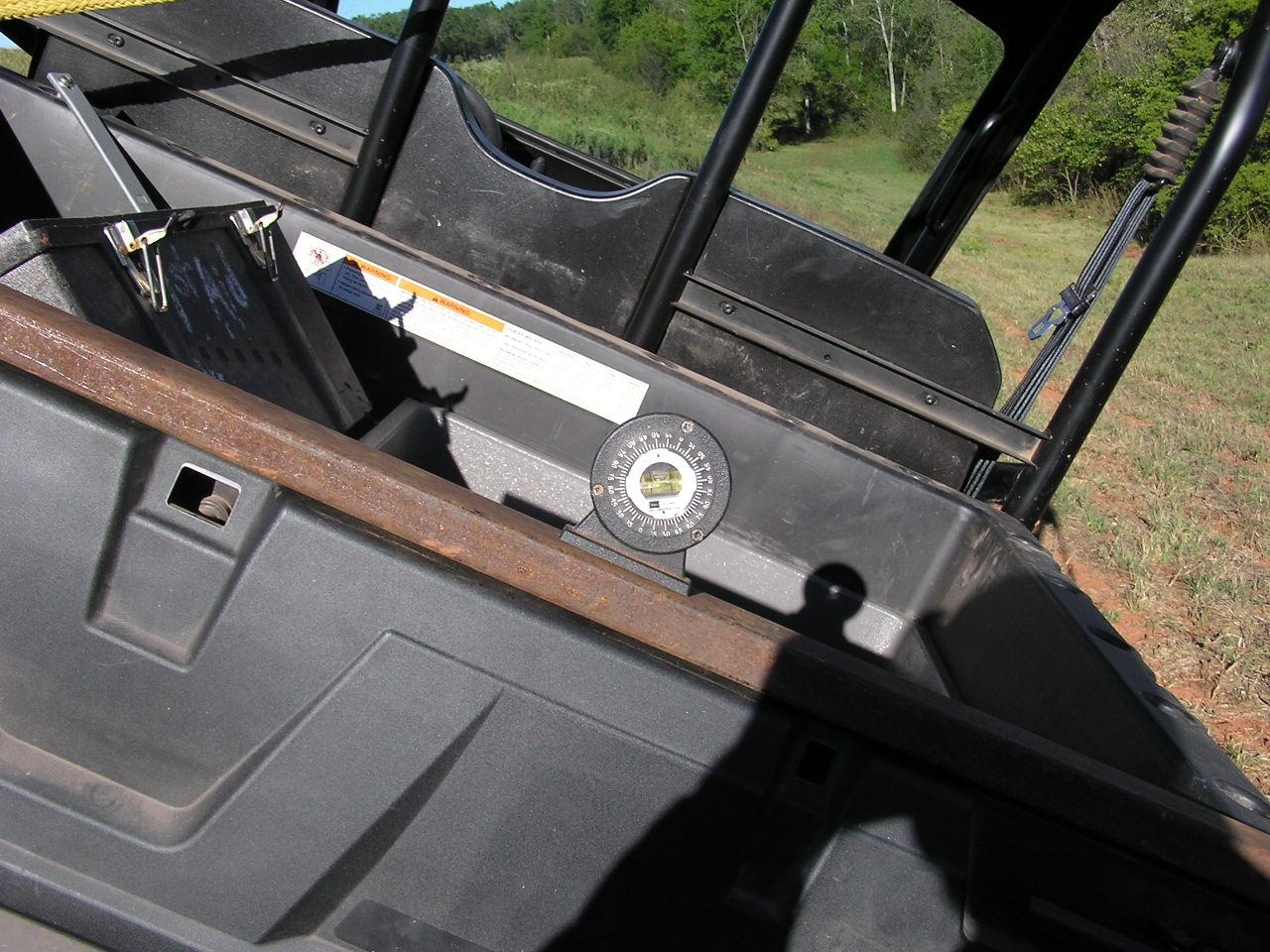

These aren't a bad idea either for your situation. They may tell you what your eyes can't. Safety
