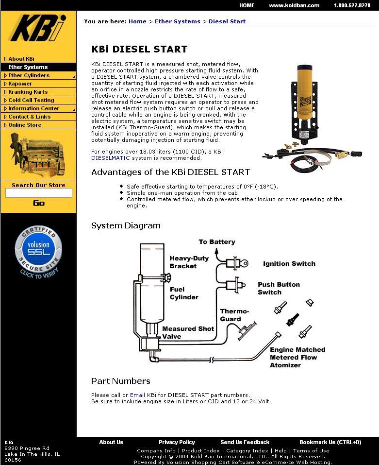

Older over the road trucks used to have Ether start bottles on them. I wonder if you hooked one of these up if it would work for you (and save you a bunch of bucks). You have to be careful not to use more than a small "squirt", but it made a world of difference in starting larger engines.
This is what I found when I did a quick search .... sorry no prices but I bet it is less than $100 bucks
Good luck

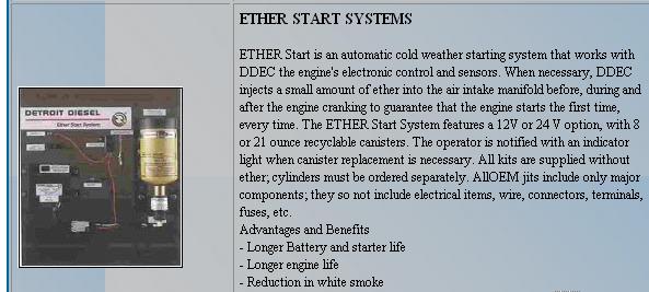

Here is another company (with a phone number) .... See what they think

Whow, don't use a quick start kit on that little Deere, you'll run the risk of making some bad things happen. Those quick start kits were made for the older Diesels in the 60's and 70's like a Detroit 71 series. The injector pumps and injectors were lower pressure and they would suffer from poor cold starting.
I looked on the Deere and Yanmar site and the engine listed for the 3005 is a DI type so it should light right off after a few seconds of cranking. I have found with the DI engines I run is if the primary fuel system has an issue they tend to be tough starting after they sit for a day or 2. The Cummins B series suffers from this issue if the lift pump or the primary low pressure supply line leaks down.
Check your supply side from the tank cap all the way to the low pressure supply port on the injector pump. Make sure you have the pressure and flow specs right. You may have a leak down issue where the supply to the pump drains down away from the injector inlet and your cranking for several seconds until the low pressure supply restores fuel to the injector pump and therein supplies high pressure fuel to the injectors.
Hope it helps,
Tom
