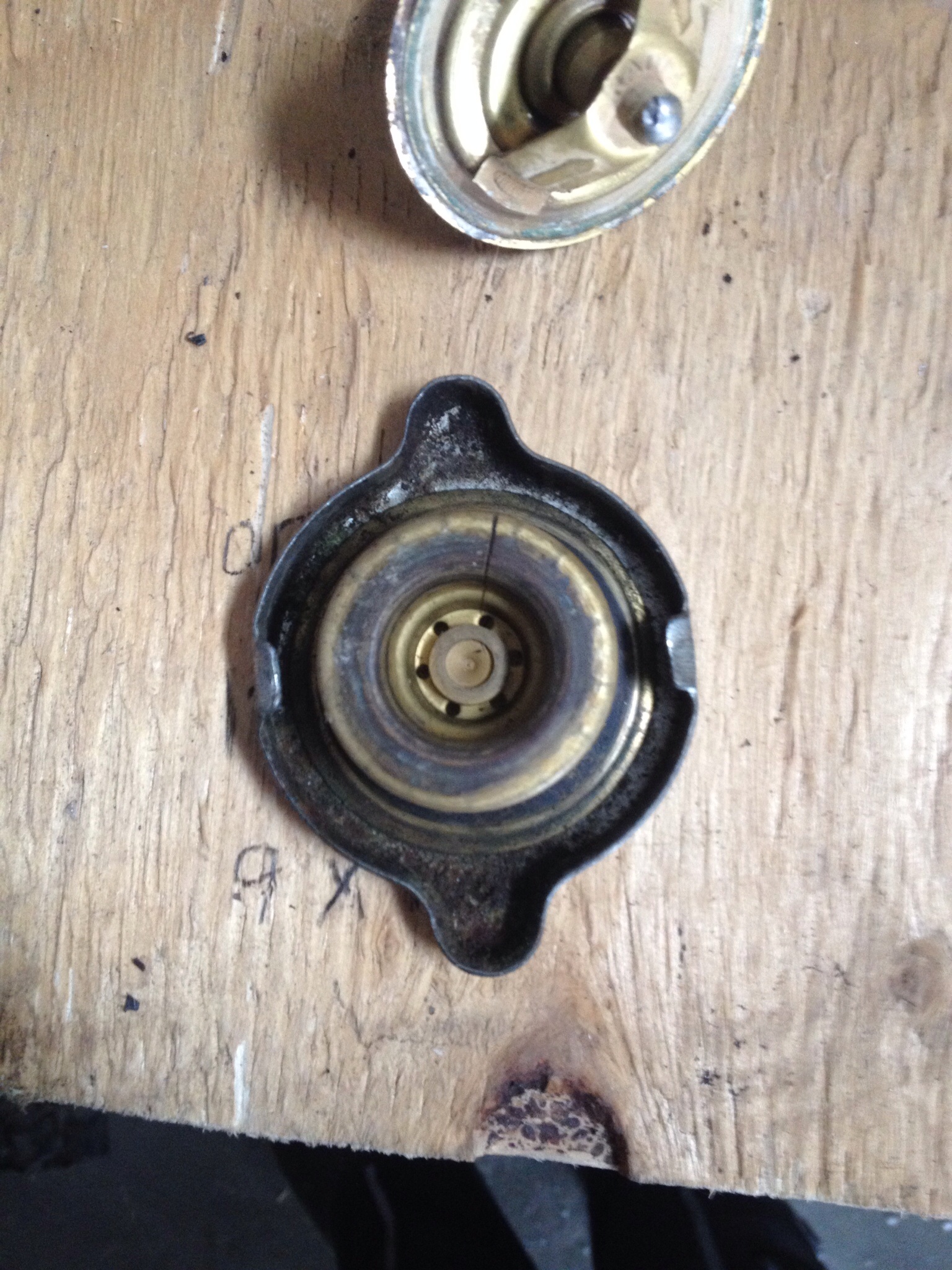

Thanks for the reply. I've done some more work ( been hanging around -22c) so it's a slow go. But I've ran the tractor with no rad cap and could not see any bubbles .. A good sign the rad cap I took off does look suspect though image.jpgimage.jpg
The crack in it might explain the coolant loss .
Swapped the t stat and added another coolant temp just in case. Ran the tractor for over an hour and temp stayed low and no coolant loss so fingers crossed I'll be running it some more when the weather is more cooperative..
   / Universal 640 dtc head gasket? #4
Cheap repair then :)
