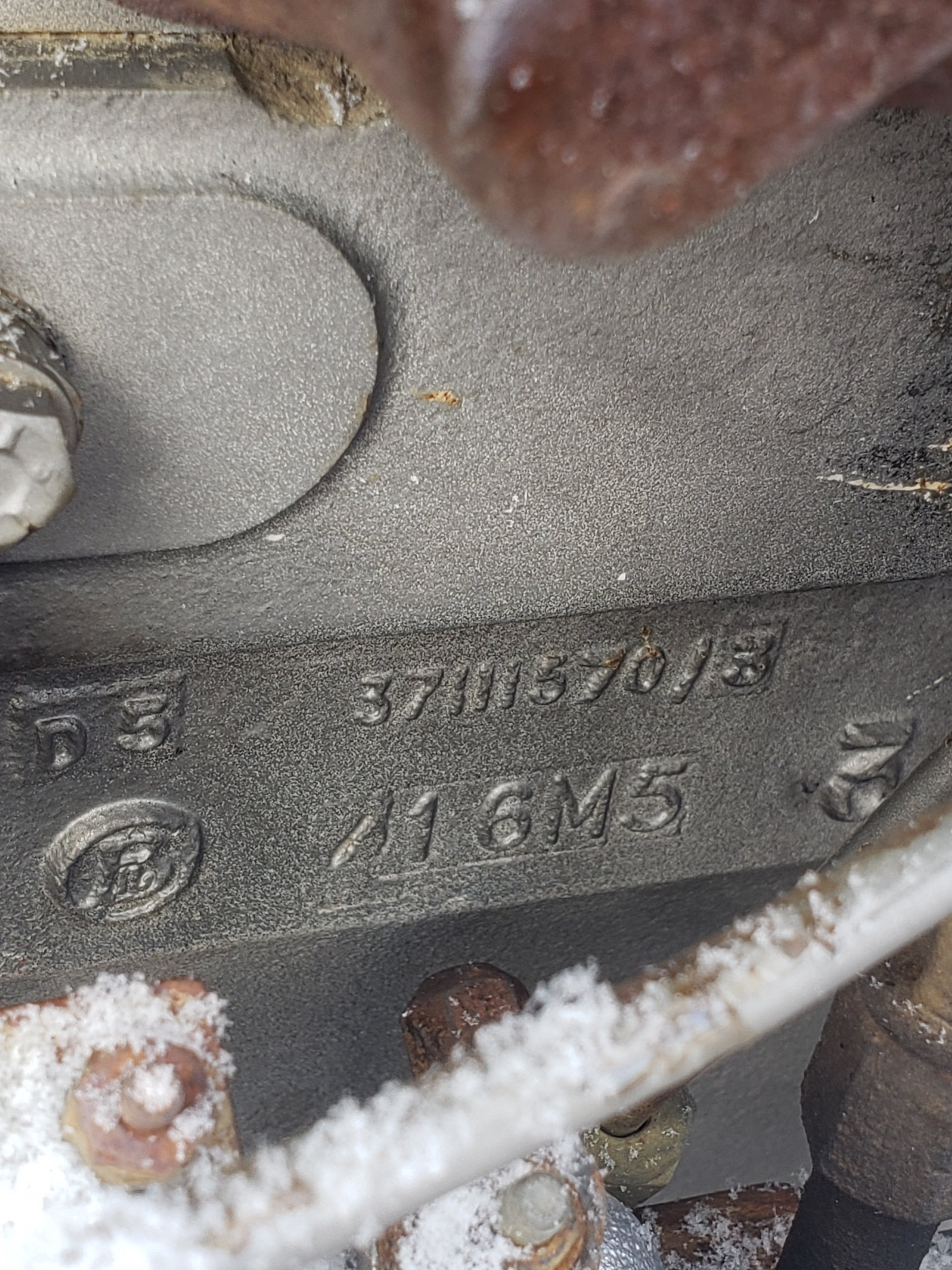

MF 235
I belive its a MF 235
It doesnt have the cover, so no model number or serial numbers
Does anyone know where to find out what model this is, what year it is
I would like to see if it can be rebuilt

More pictures of the whole tractor, those casting number don't count much.
   / Unknown model #3
Maybe tractordata.com could help.
   / Unknown model #4
That's the part number for a Massey-Ferguson 6 speed transmission case. Looks to have been used on several models. There should also be casting numbers on the axle housings, engine block, steering housing, possibly front axle, and anything else that is cast iron. Find all of the numbers you can, and write them down, then do an internet search (I get the best results using Google). That may narrow down what you have, if they used a specific housing/part on a certain model.
