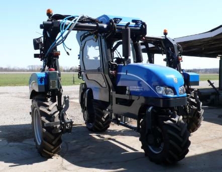

Was up in Ontario visiting some winery/vineyard folks. There is a move in Ontario to increase grapevine density plantings to the point where narrow conventional tractors will not work. The following pic is of a new, French I believe, double over row tractor that puts very little ground pressure to the soil. Slick tractor but I wonder what this costs? Attachments are pricey and double needed. If someone knows the name of this manufacturer do share...Gary

Bobard makes over the row tractors and Gregorie also has multi use over row tractors that they can use as sprayers and harvesters. I don't recall seeing that tractor you have pictured before though. It is an interesting design. I imagine it would be great for vineyards on hill sides.

Yes Robert. Each wing can go up or down independently to stabilize on hillsides.

I did a pretty intensive internet search and that tractor never appeared once. I did however find something manufactured by "JUTEK" It was called a Two Row Tractor. There wasn't much information on that one either. Neat looking machine though.

Photos from:
AXISS 8521
Bruce
[ame]http://www.youtube.com/watch?v=e1VMYcc4bUg[/ame]
   / Unknown Vineyard Row Straddle Tractor
Thanks Bruce. That's it ! The video is way cool especially the variable height adjustment....Gary
