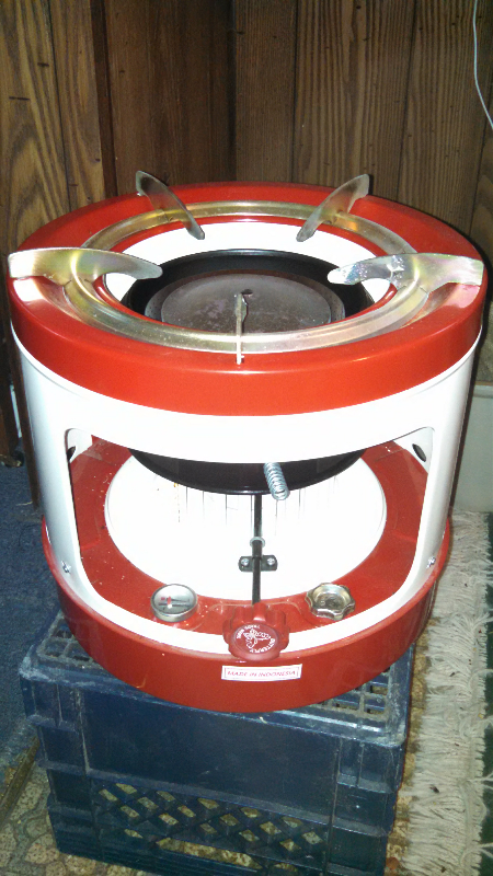

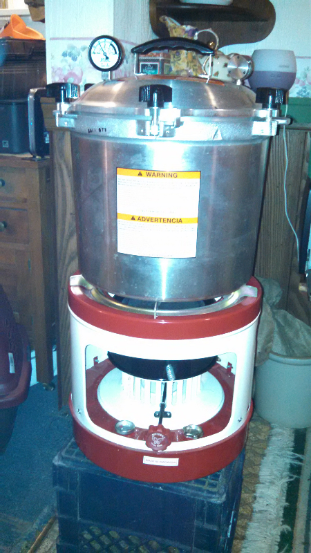

I know it seems like an odd time to be canning venison, but we were busy right after deer season, so we had everything deboned, bagged, and frozen until we could devote the time for a proper canning job. While we were getting set up, it occurred to me we're using a somewhat unique piece if equipment that some of you nay be interested in.

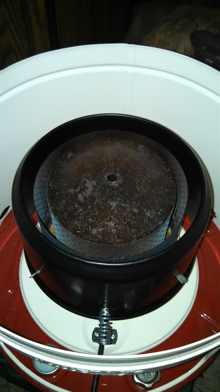

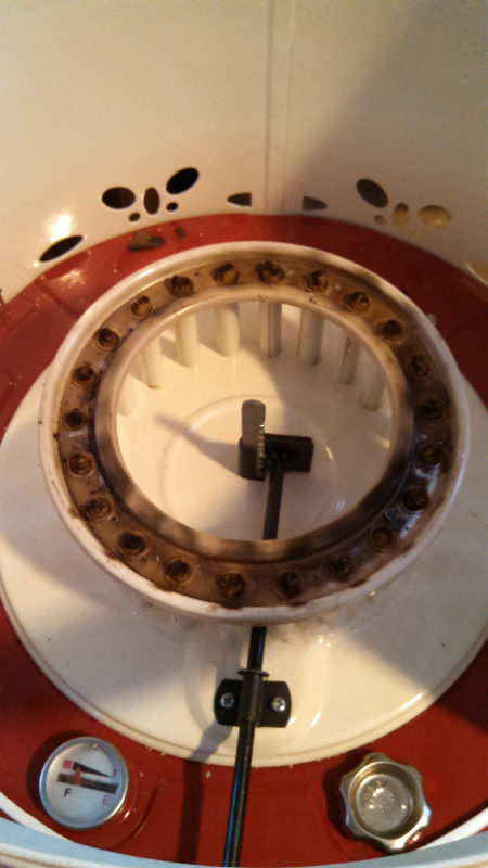

A couple years ago, we bought a kerosene stove, specifically for this process. It keeps the electric range free for normal cooking while the canner is hissing away. The stove is made by Butterfly company, in Indonesia. It has 22 cotton wicks and produces up to 14,000 BTU/hr for 10 to 18 hours, making it pretty ideal for canning.
I've posted some pictures of the whole unit with and without the canner, as well as with the top and catalytic converter removed, so you can see the wicks.
Just thought you might be interested.

Hmmm - a most unique piece of cookware. I've never heard or seen anything like that. How long does it take to run thru one canning cycle? I can sure remember my mother canning vegetables and how the kitchen was a place to avoid because it would get so hot. Then one year the canning operation was set up on the back porch and a Coleman camp stove was used for the canning. That's where all the canning was done up until the day my mother finally gave in and started freezing all the vegetables.
   / Unplugged Canning
A typical canning cycle for venison is 10 psi for 75 min., but it also takes time to get up to temperature, then the cool down. We like to have a good 3 hours minimum for the whole cycle. Yes, it can get warm, so winter is a good time to do it.
