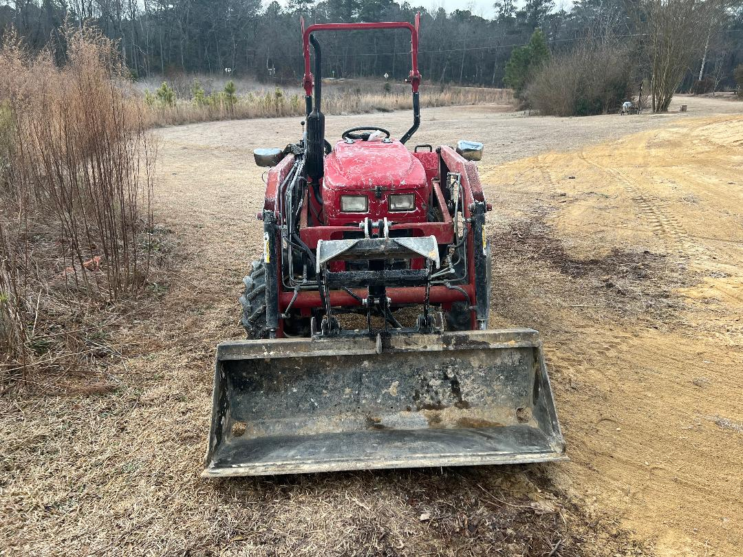

Nortrac 304. Sany SY16 excavator
Tractor has been very good to me.. It so far has done all i asked of it. I keep it in low range when ever i work it and that is 99% of the time. I recently moved to south carolina and had to dig out a spot for my garage. The 304 dug into the banking like a pro, just slow.lol . I ran into some large pine tree stumps that the 304 could not handle . I ended up buying a Sany mini excavator for that job as renting a excavator near here was very hard to get ( sany has problem that they cant seem to fix and im very disappointing about that purchase ). I change the oil on 304 after every 20 hours lol and gear and hydraulic oils every year. I add a quart of my used engine engine oil to every diesel fill. I have put 350 hours since my brother inlaw gave me ol jenny.... I love the 304 and I do not think i could ever get rid of her....
Here is a picture of hill i cut into for garage and ol jenny

Sorry i did not see this question before now. The Sany is fixed after the rep came and had it returned and repaired. After the valve body replaced , and who knows what else lol it was just two hyd lines that where in the wrong place. So far 50 hours with no trouble at all..In fact if prices ever come down I may upgrade to a larger machine.
