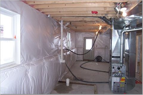

I'm in the process of framing a 5X6 bathroom in our new basement, as part of finishing off the entire space. We didn't plan on having a bathroom down there originally, but there is water close by and the main waste line (3 inch PVC) is overhead. Can anyone describe their experiences with the toilets such as Saniflush which use a motorized grinder and pump to move waste up to a drainpipe? I'm also considering adding a shower stall and sink to the same area, and their drains would be routed to the toilet. Thanks for any information you can provide.

Mine is the type you put in the floor before you put concrete in.

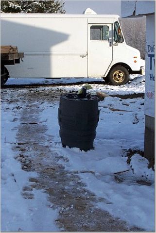

   / Upflush toilet #4
They set it into the floor and ran the pipe before everything else. It's 25 gallon and is made by Liberty Pumps

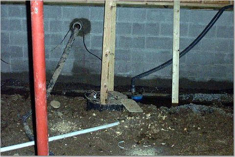

   / Upflush toilet #5
Here it's in the floor with the plumbing and you can see where my pipe goes through the wall into the septic.

   / Upflush toilet #6
The last one has the flapper installed to keep the water from coming back into the pump house. It's just like a sump pump and it's fairly quiet.
