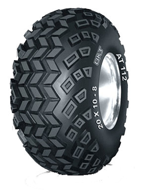

But my main issue is traction, I'm looking into some alternative tires mainly ATV BKT AT-112 7176.jpg. AG tries get a mixed bag on reviews from really good to ripped up my turf. Anything will be better than turf tires for my land. Now on that note has anyone ever tried to get a different hydro tranny with limited slip. Stock power unit is a tuff torq K46 and is it possible (in theory) to get one from simplicity like the broadmoor auto traction control Tuff torq K57 and swap them out? It just seems like a swap out of the hydro motor (Tuff Torq | LAWN & GARDEN TRANSAXLES).

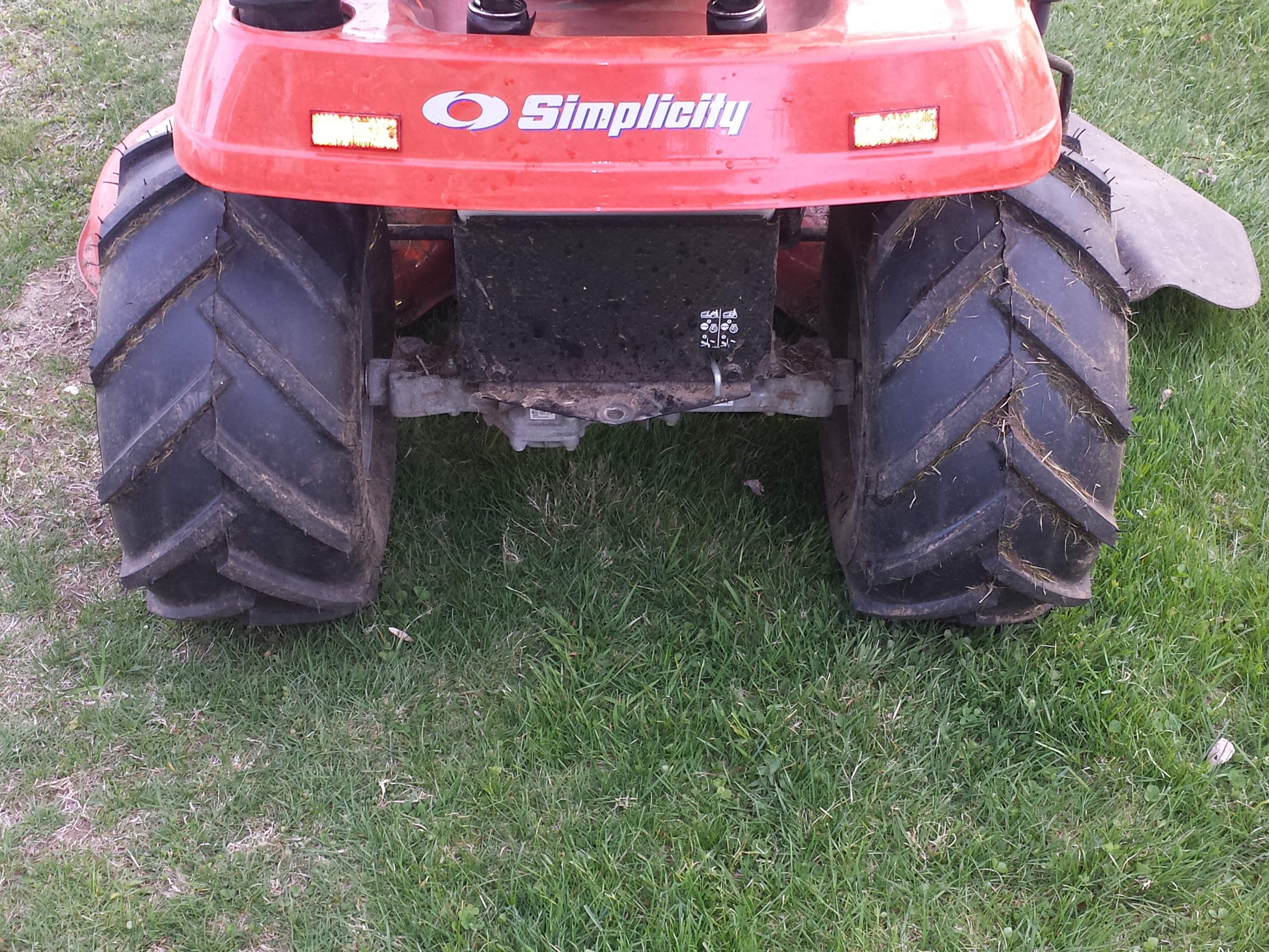

As an update to I scrapped the bkt tire wish and went with a set of super lugs from
Carlisle. They do dig in but mud never phased it, and pushed up hills I had to rock back and fourth shifting my weight
Now I just need to know where I can pick up a transmission with a limited slip. Whats stock is a tuf torq k46 im curious if I can find a transmission that has that option and will line up correctly. Any takers?
