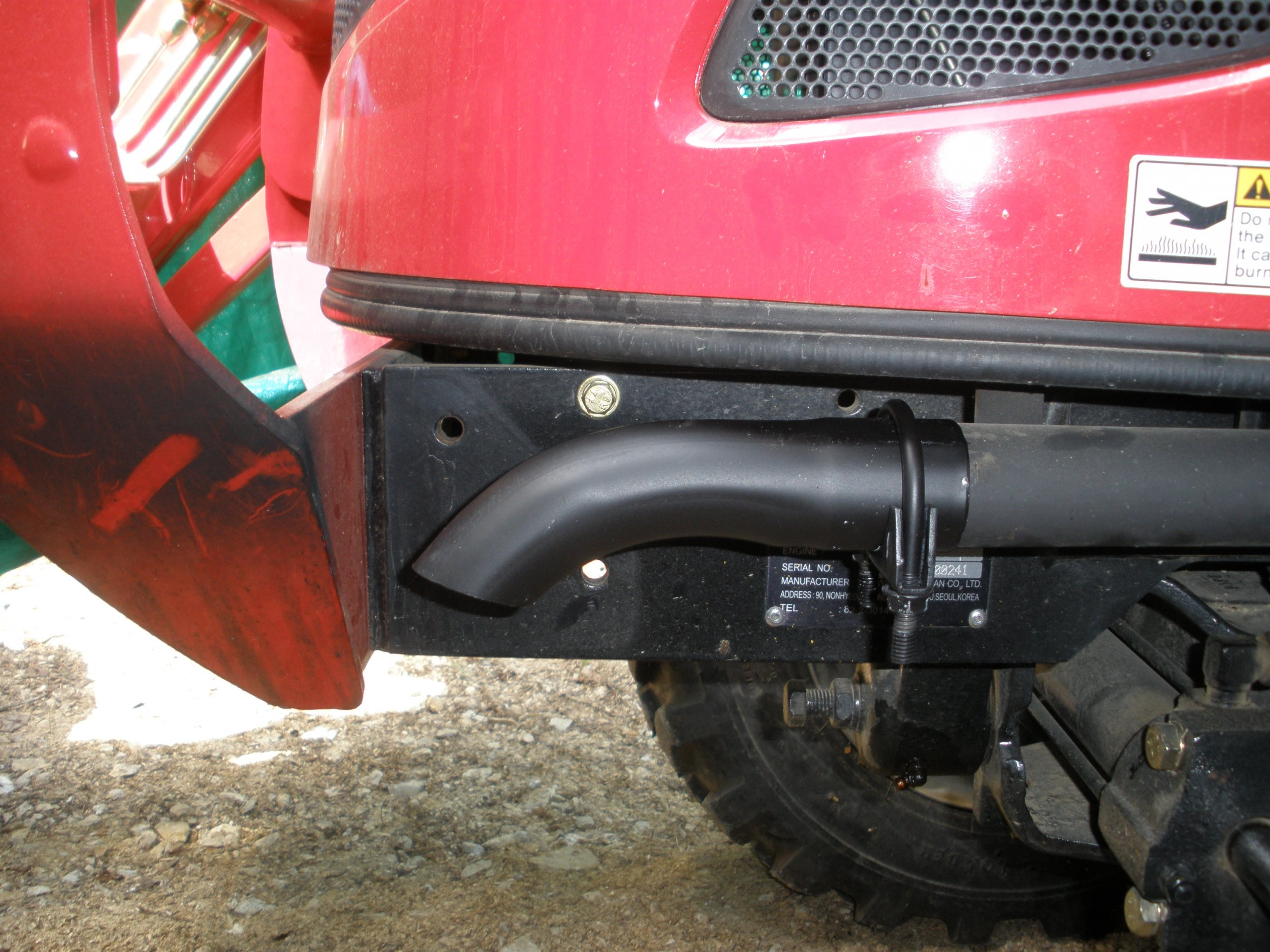

Has anyone changed their exhaust on a Kubota 2501 from the bottom exhaust to an upward one? I do have a FEL. Tired having hot exhaust blowing back on my left leg.
   / Upward exhaust on Kubota #2

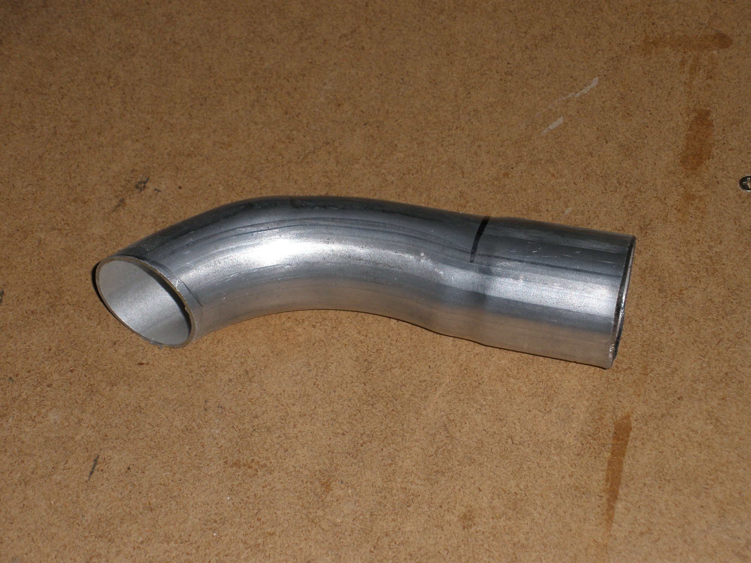

I don't have a 2501 but I did change the direction of the exhaust on my TYM. I took the diameter of the exhaust pipe to a muffler shop and for less than $5.00 the bent me an elbow and gave me the clamp. I did readjust it 45 degrees outward as it just blew dust all over when it was facing down.

I had not considered going up with the exhaust though I have considered going under the tractor and having it exit the rear. If there is enough room between the loader and the hood you could probably go up. Be sure to take rainfall into the exhaust pipe when not running into consideration. My Mitsubishi had a small hole at the curve where it went up to allow water to drain.
   / Upward exhaust on Kubota #4
I’ve been meaning to do that on my 7510 for a couple years… I think I will cut a slot in the side cover to allow an elbow out and up. I tired of the FEL always black and anytime they wind is blowing toward you sitting in the exhaust. Like the previous poster mentioned, put a drain hole in the low point… Also doesn’t hurt to leave a can over the exhaust.

I have not done this with my 3901, however I actually like the bottom exhaust. I had a 2250 with a top exhaust and definitely prefer the bottom. My experience with the top exhaust was periodically getting fumes in the face and another tractor "appendage" to be cognizant of potential branch interference (although this was a minimal concern). Best of luck on your mod!
   / Upward exhaust on Kubota #7
Vertical exhausts on tractors I had supports from 4 or 6 post ROPS and still took damage in woods.
Prefer low and to the side of my current tractors. No fumes or heat on the operator. Might try turning the exhaust slightly to the side?
