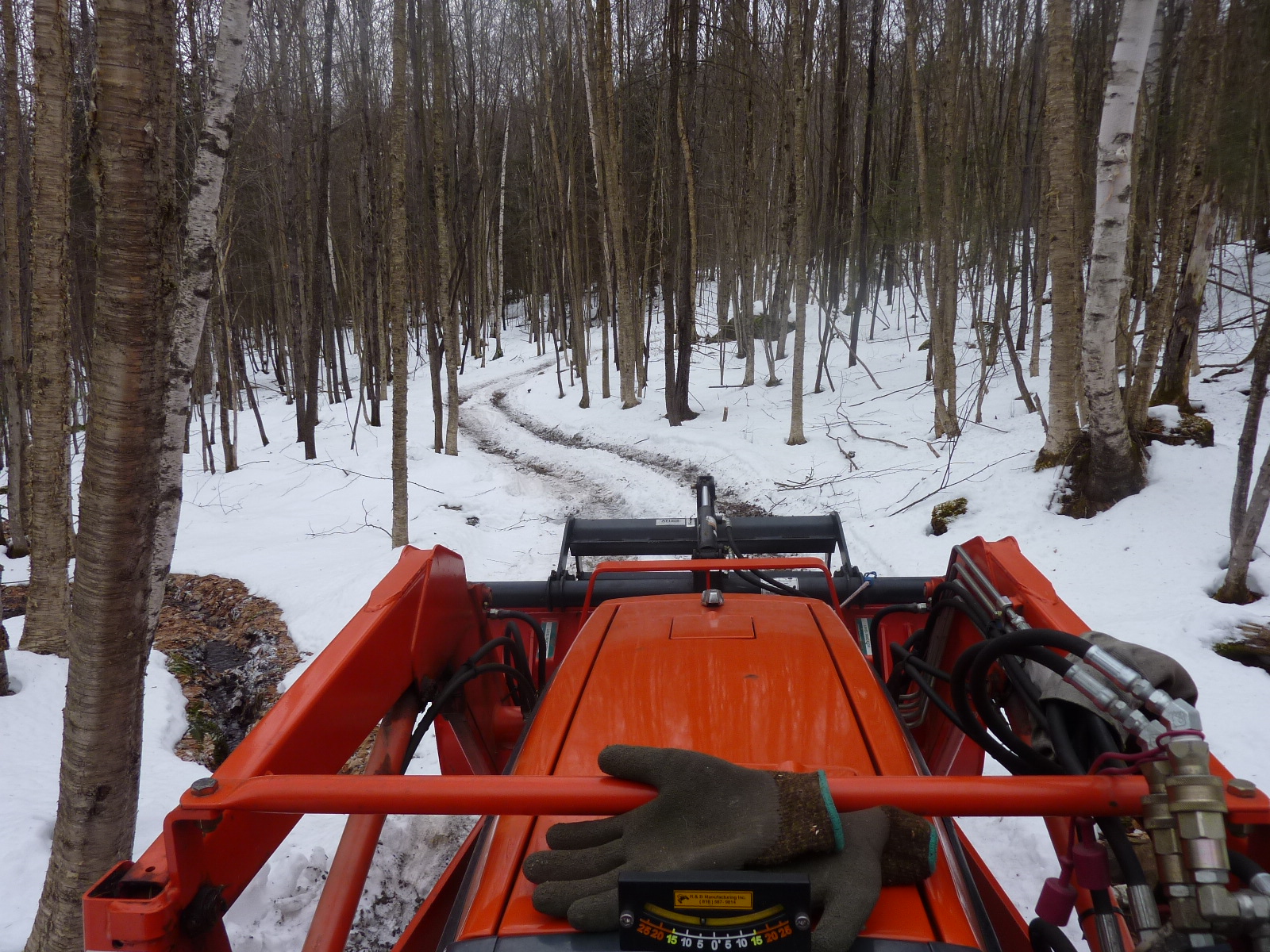

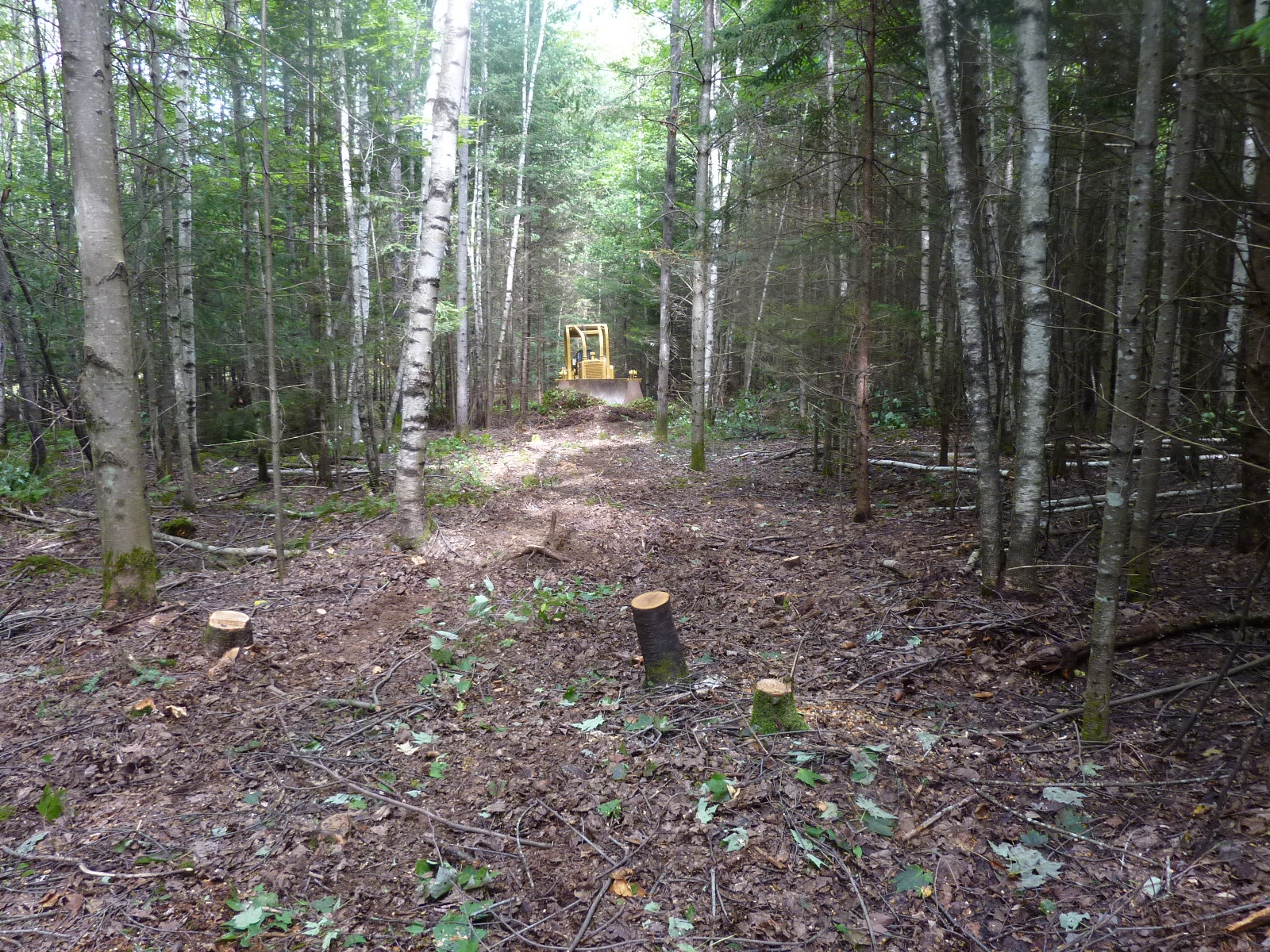

Hi guys: I have a new Holland TC-40 D and just had loggers thin out 90 acres of woodland. This has left me with about 2 miles of Skidder logging trails which I want to now keep open . I was thinking of purchasing a 62 grading scraper attachment to try, ( over time), to turn the Skidder roads into something a bit more like a passable dirt road. The roads have lots of 1 ス to 3 diameter 6 stumps everywhere, Is this the best attachment to get a handle on this project ?? thanks for your help on this jim up in Maine

Two miles is considerable distance.

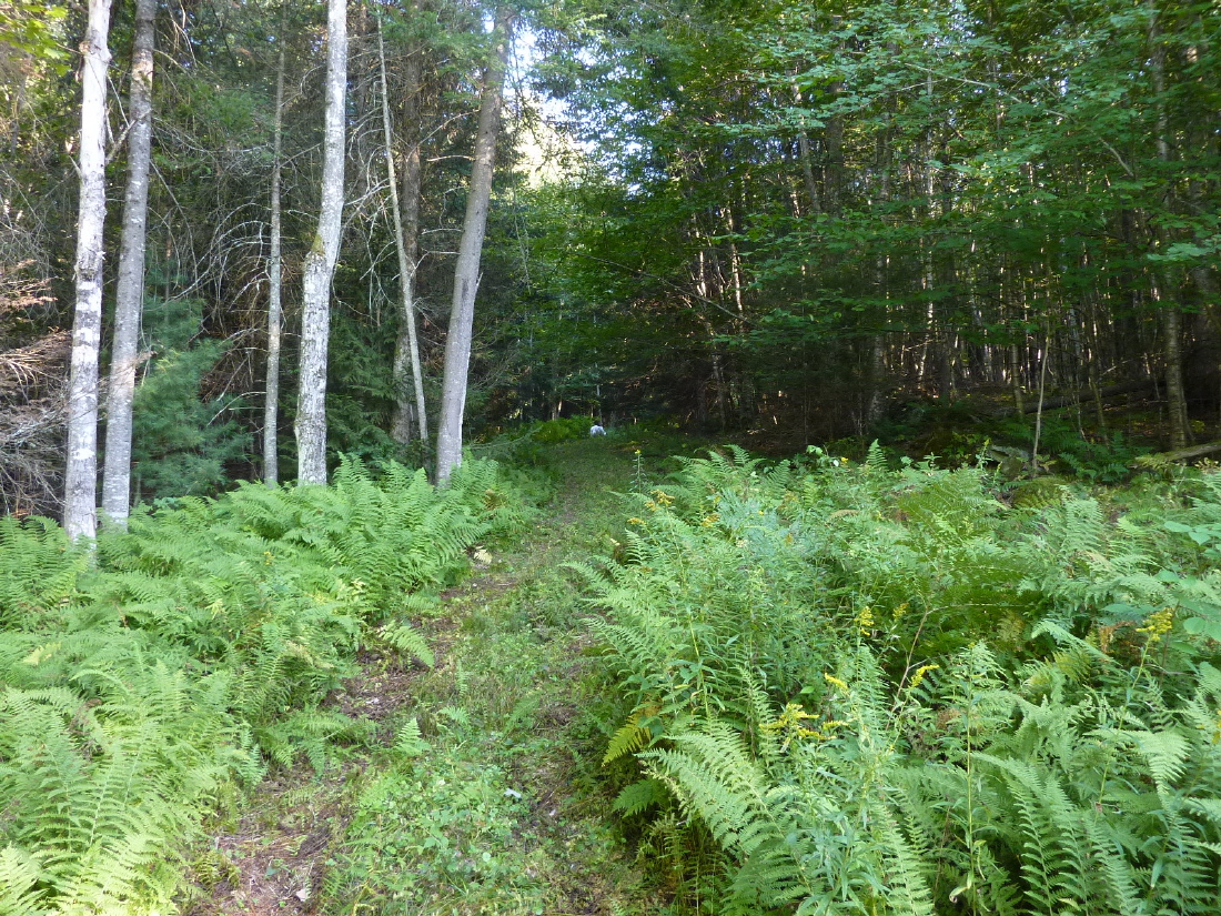

First you need to consider the potential for erosion and what grading, crowning and ditching may be necessary to prevent erosion before removing earth holding stumps. For two miles of woodland trails I would have someone with road building experience take a look at the skidding trails and give you some professional grading advice. Hopefully, grading, crowning and ditching will be limited to a few areas.CONSIDER POTENTIAL EROSION FIRST.
EROSION IS AN EVIL GENIE YOU DO NOT WANT TO LET OUT OF THE LAMP.

With the limited information provided I recommend an excavator. An excavator will remove the stumps and most of the trailing roots in a few pulls but the trails will have a stump-hole wherever there was a stump, which will need filling in after the excavator passes and topping up several years later as the ground settles.
VIDEO: mini excavator removing stumps - YouTube

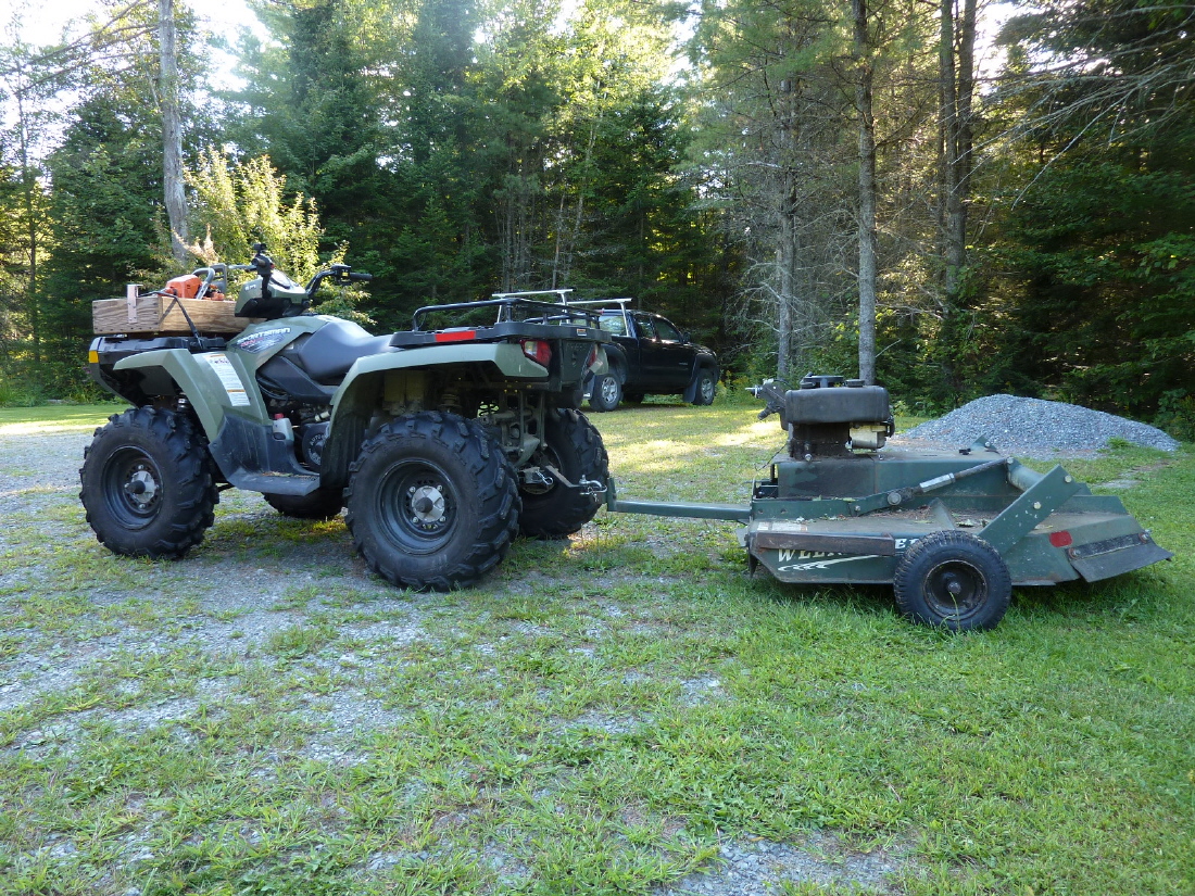

One of the first tractor attachments you will need is an FEL Ratchet Rake. Nothing better for removing brush and light grading. NOT for stump removal.
ratchet rake brush clearing - YouTube

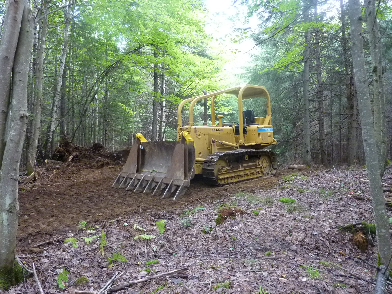

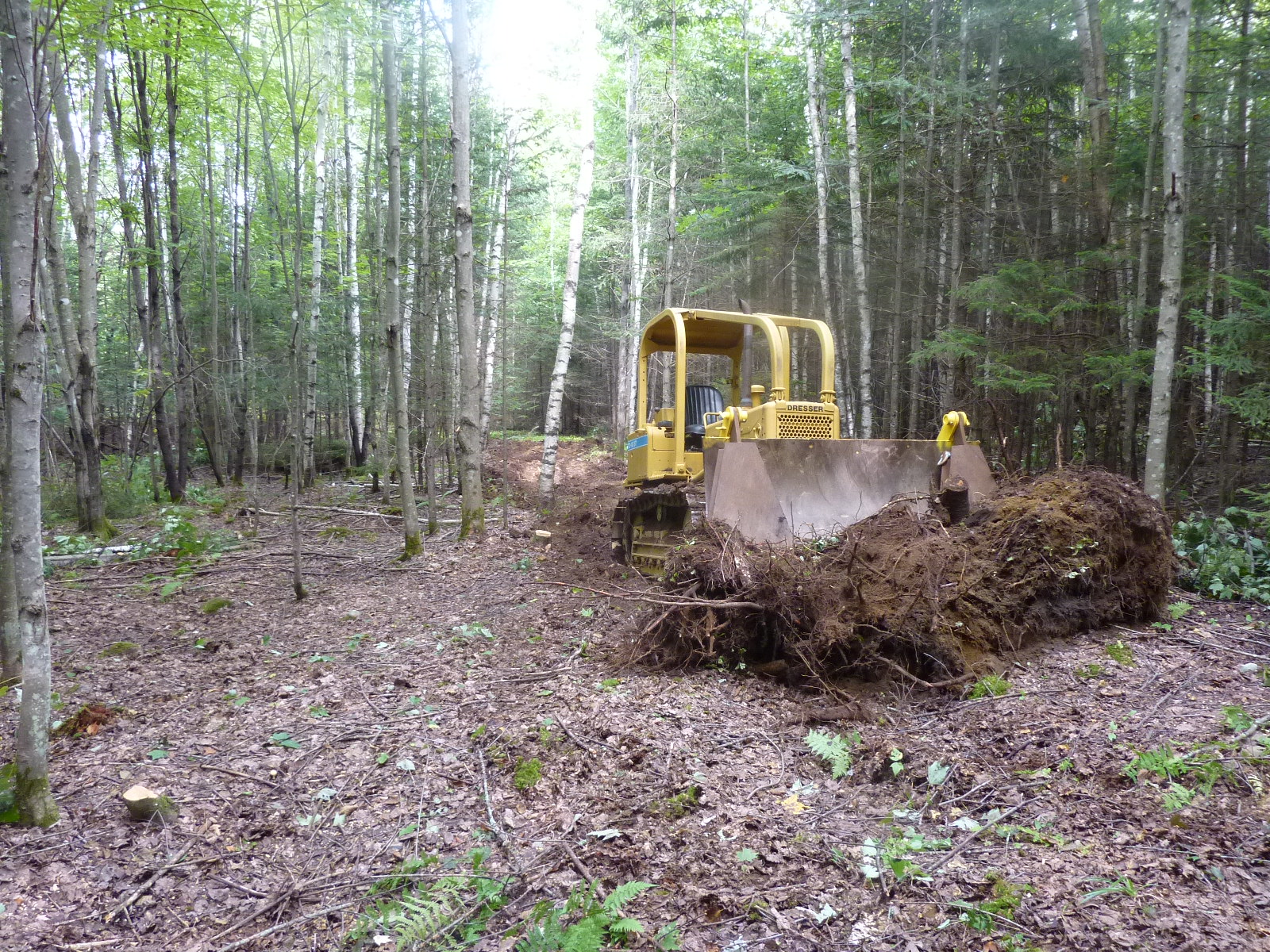

Give the stumps year or so you should be able to pop them out w/your front loader...will take time tho.

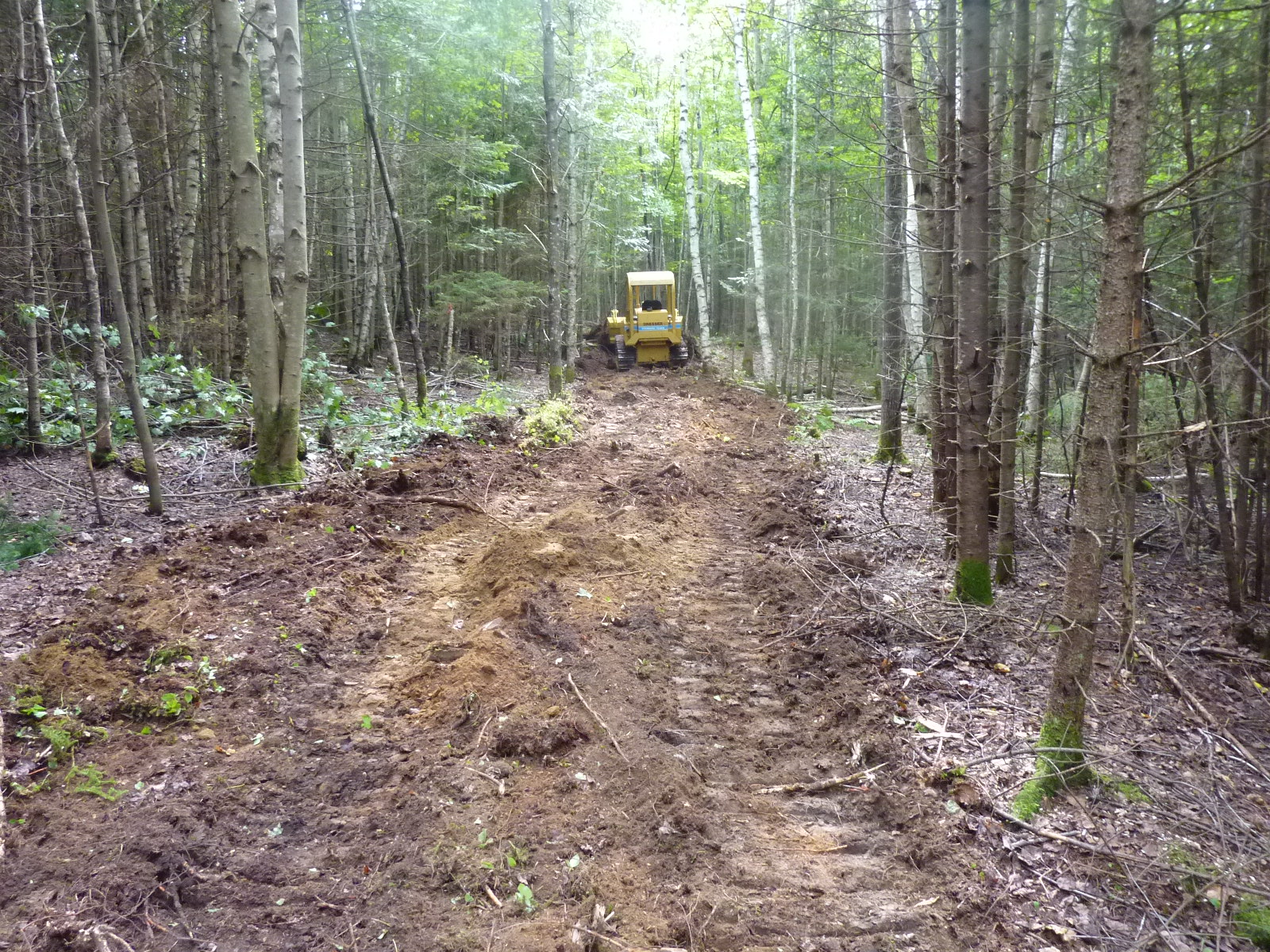

Small dozer will make short order of that task,than rear blade for finish touches.
