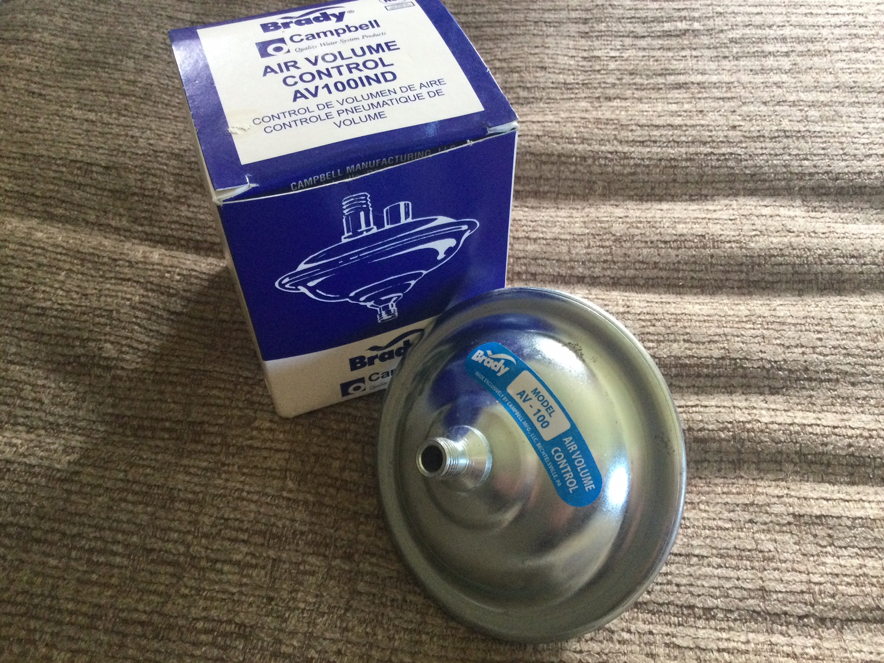

My mom just replaced her “air-over-water” ballast tank. It probably was 70+ years old. It never had a bladder. Strictly air over water in a sealed tank.
To counter the air dissolving into the water with no bladder, an “air make-up valve (also called an “air volume control valve”) is used on the tank.
Every time the jet pump starts, a ~1/8” tube from the jet pump sends a pulse of water to the valve. This pulse pushes on a diaphragm in the valve and the other side of the diaphragm send a gulp of air back into the ballast tank, ideally making up lost air that has dissolved into the water since the last time the pump started.
