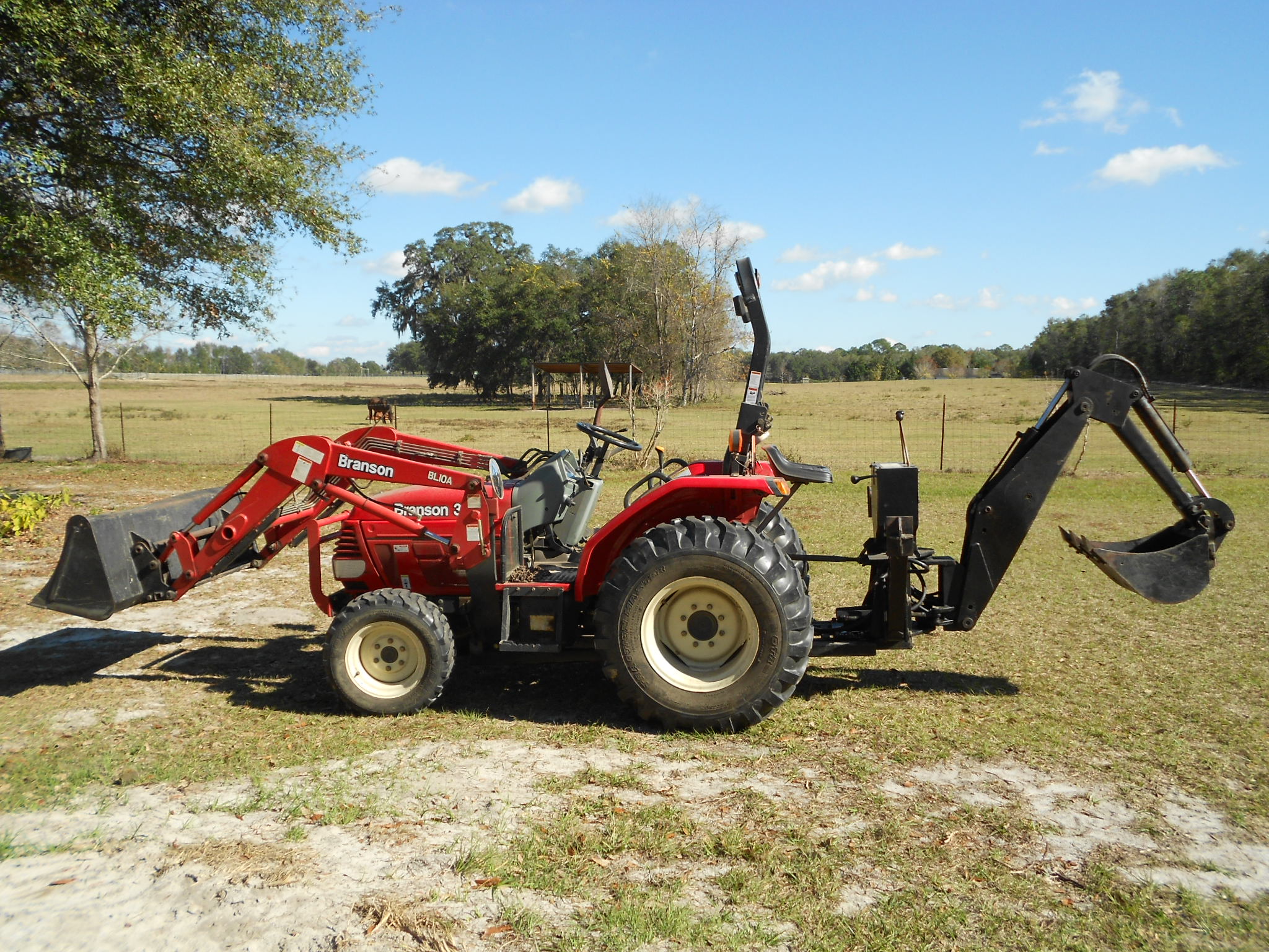

I made a subframe and adapted a Jinma Hoe to my 3510 Branson and put the top link on to make it more secure.
Used it for about 12 years but sold it recently and bought a new hoe.
You can see the top link in the pic.
Also mounted the seat using another hole and pin.
