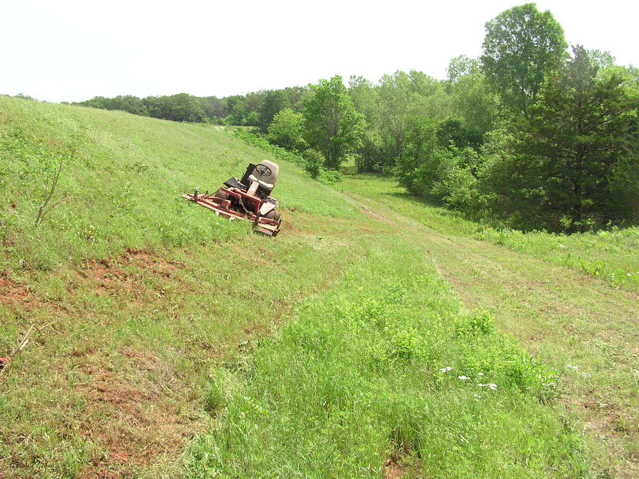

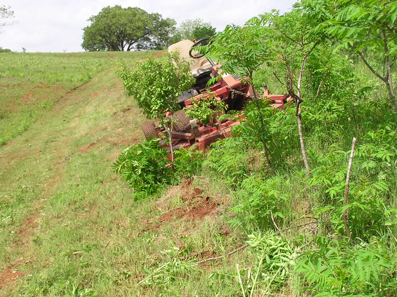

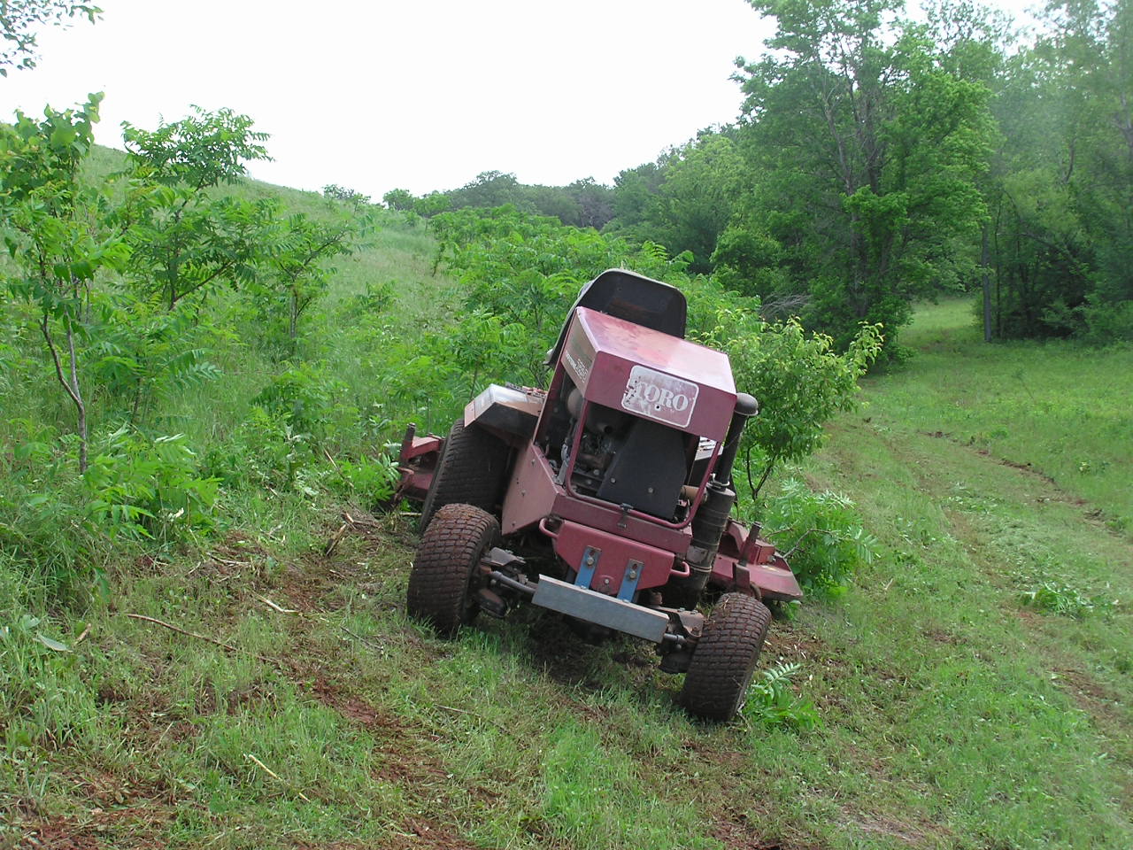

This is my "hill". :D
It is about a 27 degree slope. Even with 4WD the machine will slide sideways down hill! :eek:
