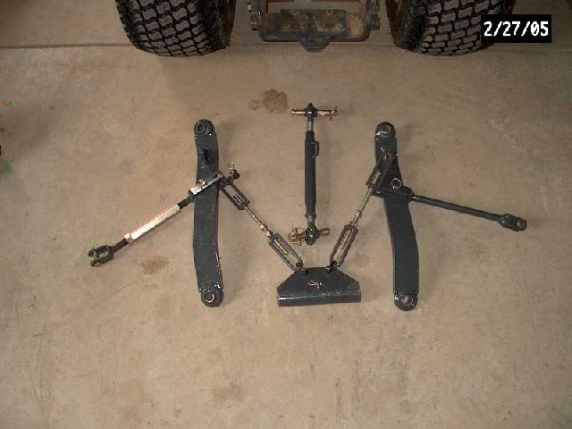

Tollster,
I forgot to welcome you to TBN in your thread in the Buying\Pricing forum so, Welcome to TBN!
Here's a posting tip. You probably should have posted this in response to your earlier thread, so we don't get repetitive threads going. No biggie.
Anyway, I took a pic (attached) of my 3ph for you to reference. The Cat 1 toplink pins you'll have to buy on your own.
   / Used BX 23, What to look for, extra parts?
Thanks, Very good picture, I'm gonna print.
