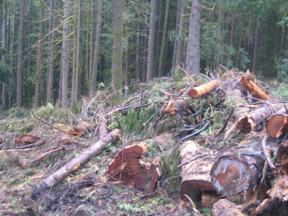

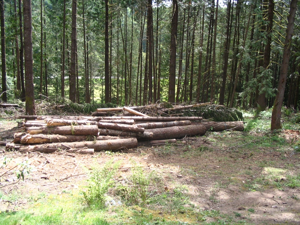

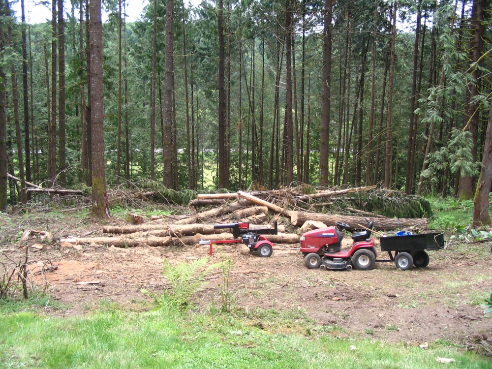

I've considered getting a FEL with grapple or 4-in-1 bucket. But, the BH just seems more suited to disassembling those big piles the loggers left.
Here's a photo that will give you an idea of the slope:
http://www.bigelowsite.com/tree_harvest/photos/photo26.html
I've also attached a few photos of some of the piles I'm going after. Footing is not very good, and I've slipped more than once with a chainsaw in my hands.

Your evergreen forest is thicker than my hardwoods were. The sticks they left you would be worth quite a bit of money around here if they were cherry, oak, hickory, etc. and sure wouldn't be left lying around.
What situation are you in regarding fire? I would want to get a pretty decent area around the house clear of that standing tinDer.
After seeing the size of your debris, I'm thinking you might want to look at a bigger and heavier tractor than the 29-35 series. Maybe a DX-40 or just a D-40 which is a more basic tractor with a lot more guts. Quite a few guys on the NH forum own 40's in red or blue and you might want to check in there.
The 40 is also more suitable for BH work.

Those pictures were taken at the beginning of the summer, and I've gotten quite a bit done since then. Most of the larger logs (18-36" in diameter) from that pile are cut up at this point. Some of them, I'm not certain why they weren't taken. Most of them, though, were either rotten in the center, or had huge warps in them. All fir and cedar, and the cedar tended to be the ones that were rotten and full of termites. (I cut the rotten cedar up and have it in a pile by my bonfire pit).
I did have a guy with a portable saw mill come out and take a look at the logs. He could cut them up for me, but would need them hauled out to a level area and decked up. I hauled out a couple with my Blazer, but that was just too much work, and hard to get them where I wanted them.
Yes, there is a fire danger during the summer that I want to eliminate. Also, before the thinning (took out 56 million board feet of lumber from those 4 acres), we had a lot of nice trails, which are now covered with the tailings.
The big logs were easy to deal with, but the tree tops are the hard part. They are only 6-7" in diameter and 10-15 ft long, but full of branches, and they are all jammed together. So, I cut off a few branches, spend time digging them out of the pile, cut off the new branches that are exposed, dig those out, and finally get a log exposed, which I then cut up. If I could just grab onto that log and pull it out, it would be much easier to cut up...
