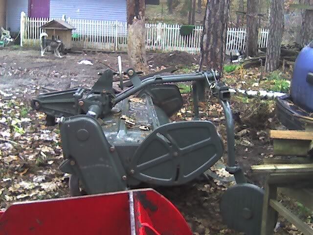

Mine has been on its side, upside down and tipped down and has never leaked a drop of oil.
These tillers are great! The gear box takes "gear oil." My yellow plug on the top also has a dipstick build into it, but I noticed that there is a plug on the side of the gear box also for level measure. You can see the gray paint is not sticking to the yellow plastic dipstick filler cap.
The chain case can be filled from the filler on the cross tube and the level is marked by a plug that is only about a third of the way up the chain case. You can just see it over the edge of the roll over box side plate.

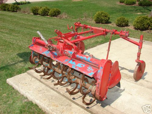

heres what i picked up off ebay this weekend pick it up next week.. should go well with my ym2000 cant wait to put it to work
