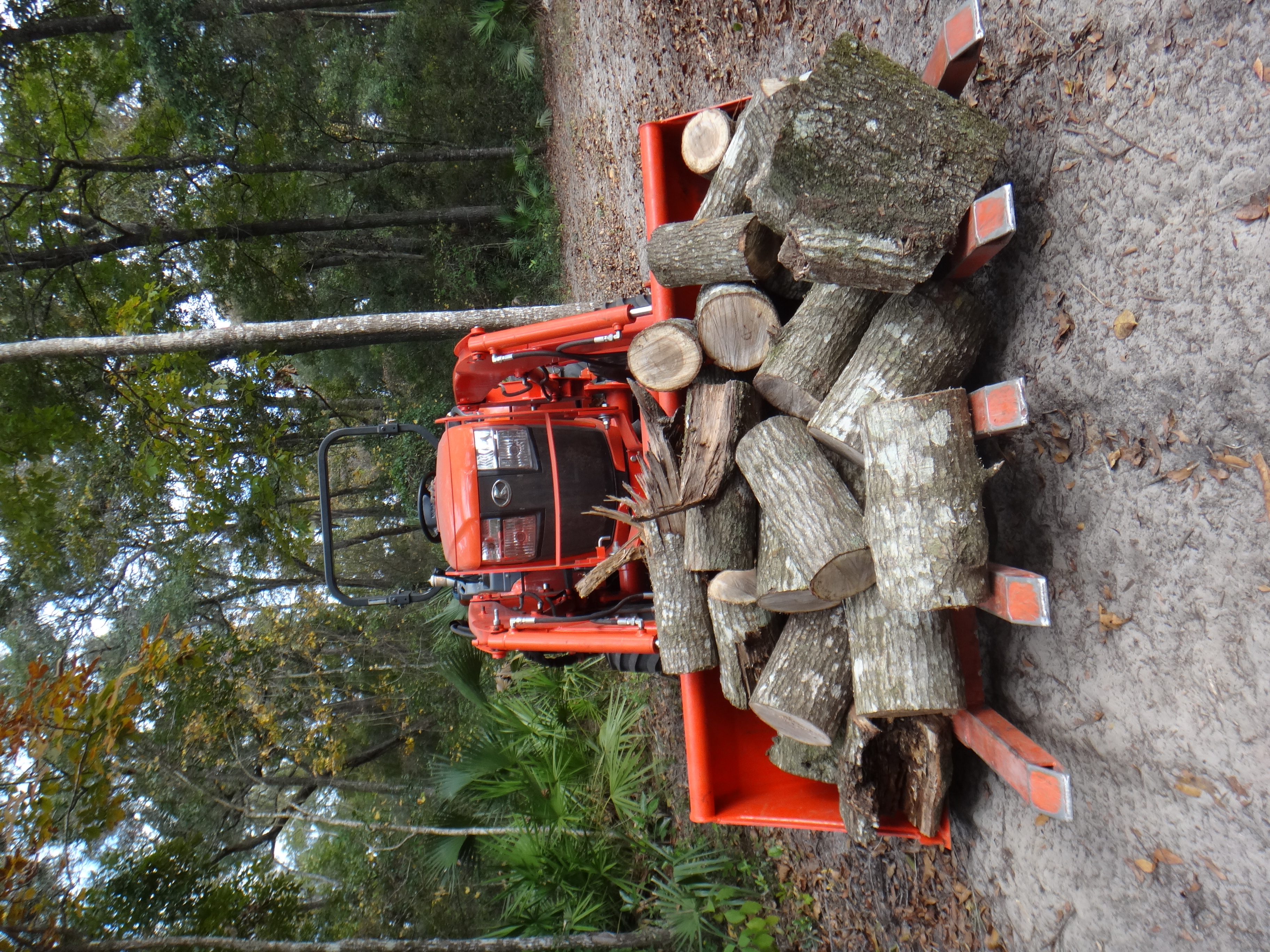

Branson 4020 very near same specs as my Kubota L3560. For commercial work I would not buy one pound lighter than Branson 4020 bare tractor weight of 3,624 pounds. $15,000 is certainly an attractive price for the package, assuming the machine is in good shape. For commercial application I would fill the rear tires 3/4 with liquid, for stability.
As the Florida soil you will be working is probably soft, and the land flat, like mine, the Branson 4020 may be just enough. I trust you will not have employees under the age of 45 years operating the tractor.

If buying new I suggest HST transmission. You will be hiring casual labor and HST will be safer around bumptious, incautious workers.
If you consider an MX also consider equivalent Grand L. MX and larger Grand Ls share same heavy-chassis. The HST/PLUS transmission on the Grand Ls improves productivity considerably. Worth the expense in commercial application.
Photos are MAX loads. I seldom work my tractor at MAX.
Tractor reliability is primarily a function of the prudence and experience of the operator.
