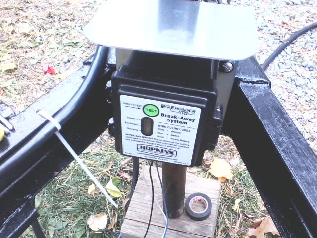

check (or more likely) add brake-away e-brake kit.

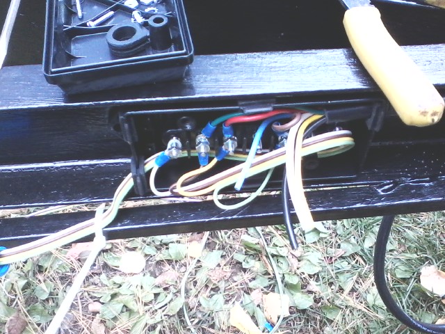

check all your lights and wireing. (add replacements to your order list)

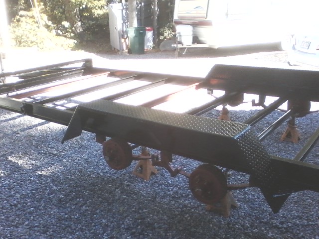

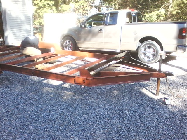

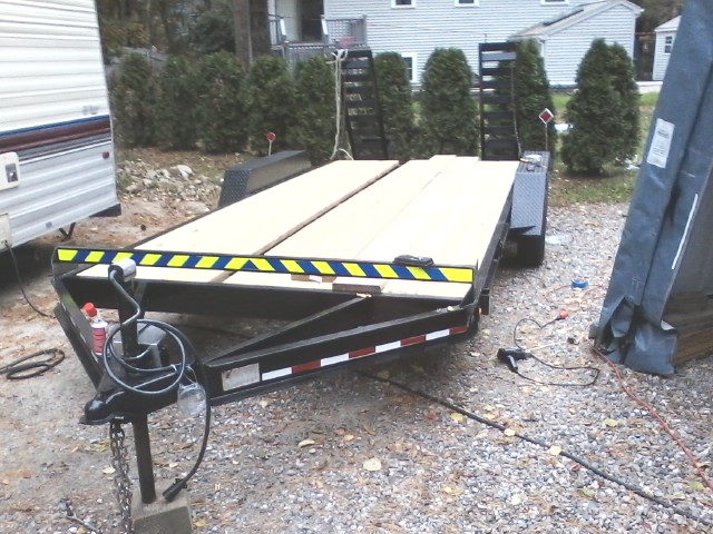

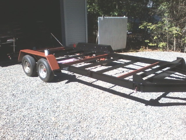

Quick update after letting it sit until I found some time ... stripped the frame...wiring... brakes....bearings....now 0927150948-00.jpg0927151242-00.jpg0927151513-00.jpg1024151624-00.jpgeverything new....Thanks, etrailer.com almost completed and I can't wait to get my tractor up and on.

It looks like you have 6 lug drums , that seems to me to be a 10K lb trailer . usually dual 5 lug is 7000 lb dual 6 lug is 10K lbs , and dual 8 lug is 12K to 15 K lbs

That's a nice trailer and you got a great deal on it. Is the ramp spacing correct for the BX? looks a little wide in the photos. Is the ramp spacing adjustable?

Hi guys and thanks. It has 3500 axes with electric brakes on both. The ramps are adjustable. I'm into it for -- $200 PT decking-- $300+for bearing,brake, grease buddies, and wiring , etc. New around here seems to be about $2700 - $3200. However, I liked the construction of the frame on this one and felt it was worth the sweat equity over new.
