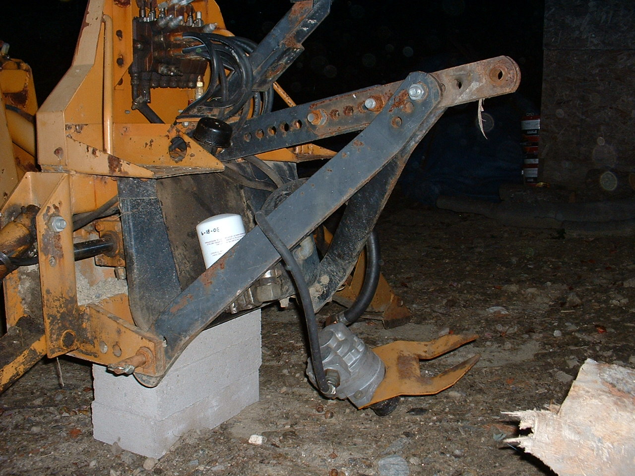

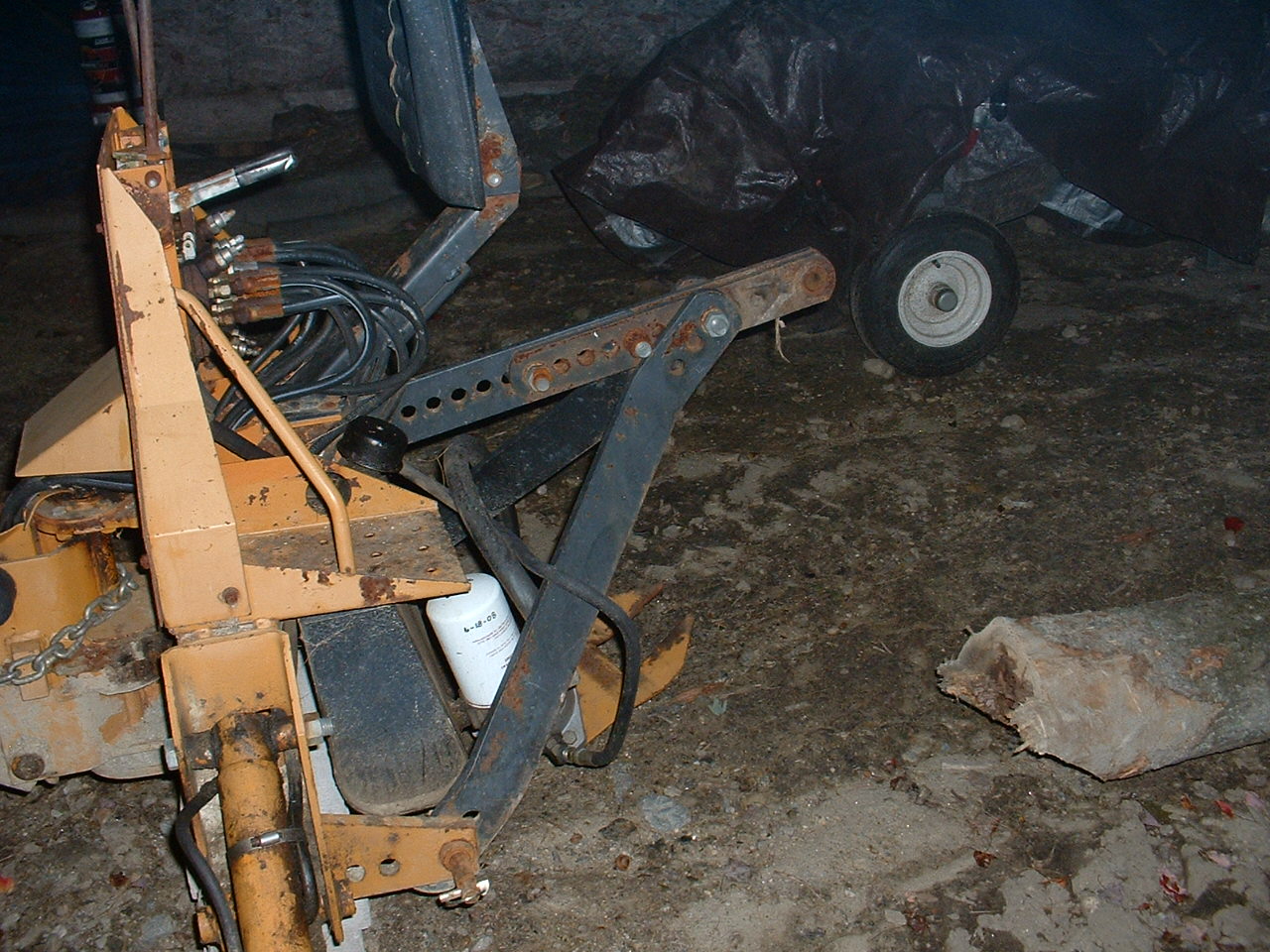

The rigid top link you have is just part of the rigid three-point available from Woods. There are also two peices that are missing. Instead of trying to explain how they are supposed to fit I just ran out and took some pictures. Our 750 is mounted on our 1900 Ford and works really well-plenty of power although it is PTO driven and Im not sure how that compares to your style. Yes, the cylinders are rebuildable- I have the 750 manual if you need more info., Rick
   / used woods 750 for my kubota b7800 #7
Forgot the pics.......

I was researching the manual and parts lists on messicks and came to the same realization as to the missing 3pt parts. It looks like this was originally a 3pt pump driven backhoe that somebody chopped into a skid steer qa w/ quick connect backhoe.
Not only are the side pieces of the 3pt missing, but the two piece top link was cut and welded. I will have to pickup a new two piece top link a well. It seems the whole 3pt kit is around $350, might as well just get it all I figure.
As for the missing PTO pump, this is a bigger problem. The labels on the backhoe seem to clearly indicate that this had a pto pump at one point, but it looks like the whole system was chopped out including filter, tank and all hoses. The two in and out hyrdo hoses now on the backhoe connect directly to the valve chamber. I'm not quite sure if I can just adapt the in and out hoses to my rear aux, or if I should add a filter, or add a tank, or add the whole kit. The whole kit is expensive... Hoping I can just use an inline filter and direct connect to rear aux with no tank.
Plus the 2 or 3 cylinder rebuilds and I got quite a project here.
