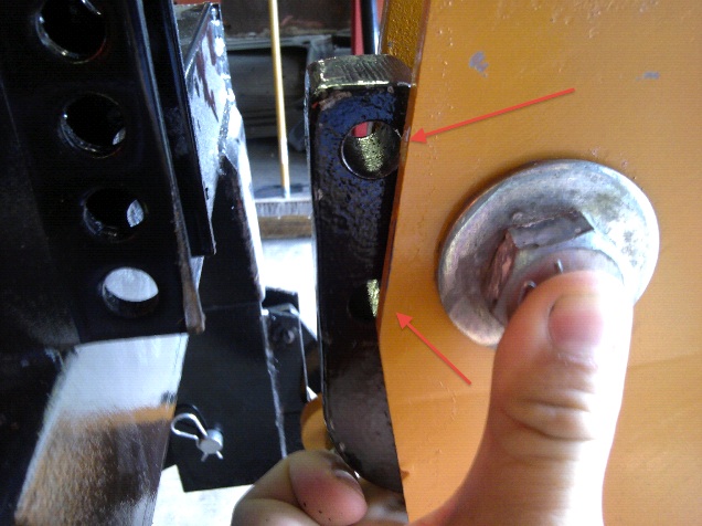

The hook can't go all the way in to the implement pin because the implement frame hits the bolts, as shown in this photo. The removed hook is engaged with the pin, but the implement frame covers the bolt holes.

Same problem as Harbor Freight hitches. The hook doesn't stick out far enough. The pins holding the hook hit the implement frame before the hook engages.
See modifications here:
http://www.tractorbynet.com/forums/attachments/252974-quick-hitch-problems-post2944942.html#post2944942
Bruce
Main problem is the adjustable brackets hitting the implement. A QH without the adjustable top link should not have that problem, yet stick out the same dimension from the main frame.
