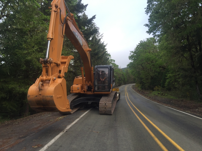

I'm at about 3000 hours on my 305 and it's about time for some new rubber on the tracks. Otherwise it's been a strong machine and I have done some pretty impressive things...
   / Useful life of a CAT excavator #7
At 4,400 hours it's past where a rental yard would want it because it's now at the stage where repairs are going to be needed. It's nowhere near wore out. At 8,000 to 10,000 hours is where most machines are too wore out to be productive. Still might be fine for farm use, but not to make money with. If the price is good, I wouldn't hesitate on a machine with that many hours unless you where trying to make a living with it.
I would agree with Eddie.
My dad and I bought this machine for farm work, 8500hrs. It's certainly not new but it has served us well for our projects. We looked at quite a few machines and found a number of machines with 12k + hours that still ran fine. We also found a few w/ 4K that were beat to death!
