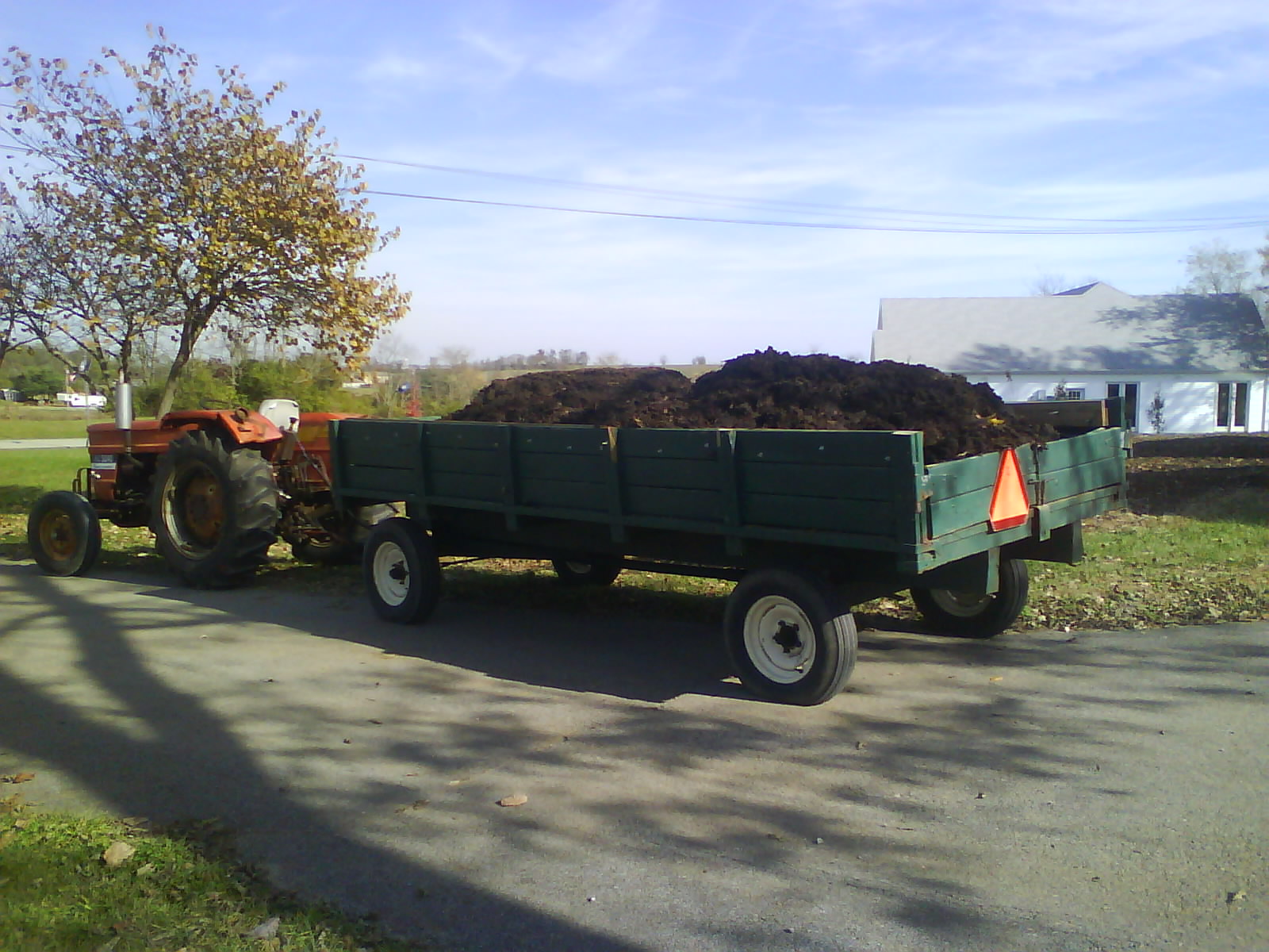

I bought a great 14' dump wagon on Craig's list last summer for $800 and I use it a lot. A friend about a mile away gave me some great top soil from dredging a pond. I needed it to cover fill dirt from our house construction in an area that we want to garden. After I got that spread I went about 4 miles and got 2 year old horse manure that looks more like dirt than manure. We have also allowed leaves and chips to be dumped in piles to compost on our land and that is getting in pretty good shape now so we hauled several wagon loads of that material for large flower beds. At $800 if I ever get to the point that I am not using it I can always get my money out of it. In our area 12 to 14 foot dump wagons sell on Craig's list for $600 to $1500 dollars. The dump and bed part are mounted on a farm wagon so top speed behind the pickup is about 25 miles an hour.
