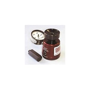

oh and the sherline
is $130 for the 0-1000lb.. vs having all the materials you need (jack stands, 2x4 and bathrrom scale) for free
