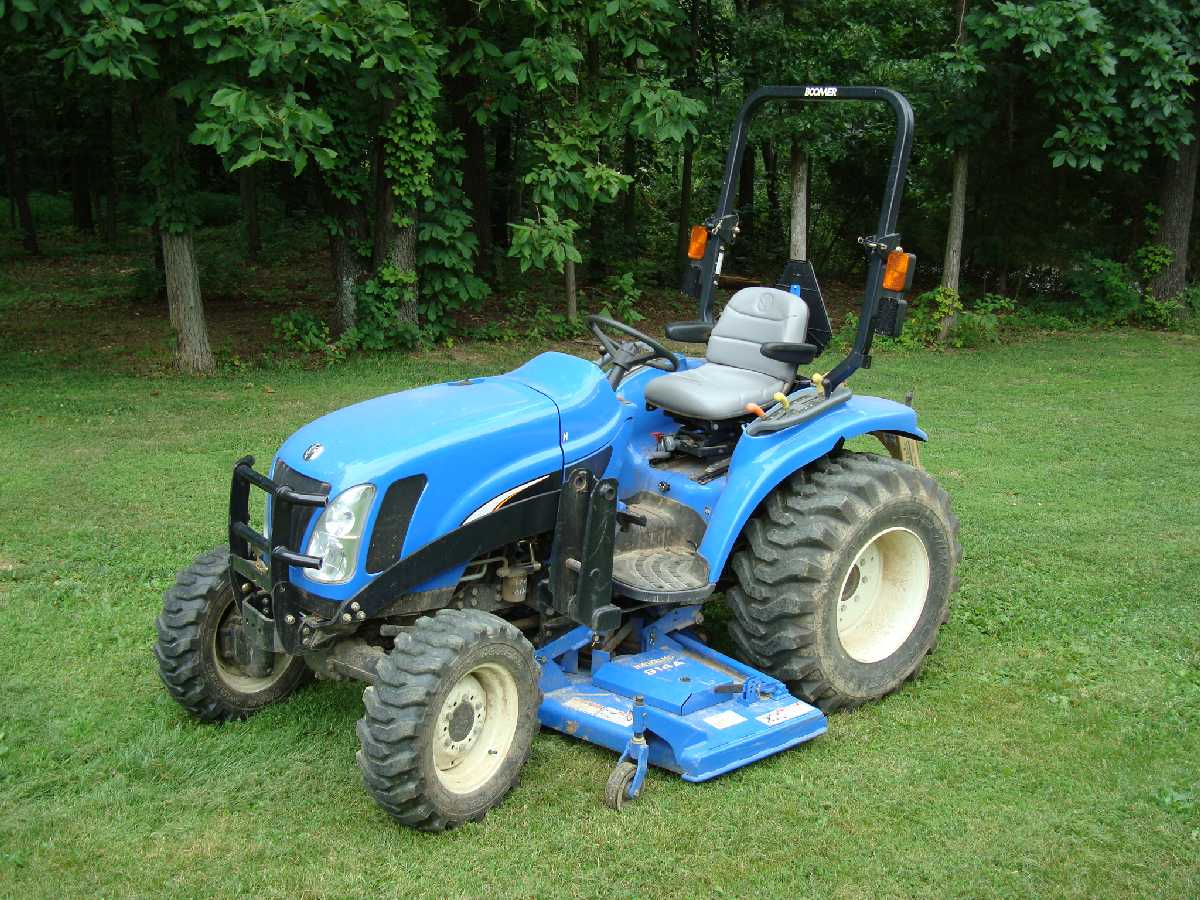

I use a New Holland TC-33DA with 72" belly mower and have great results. I really like the rear discharge!
I realize my tractor is higher horsepower than you were asking about but...my tractor is heavier with industrial tires and a larger deck and still provides a quality cut. As you mentioned, a CUT would offer more versatility (loader & attachments) than your current lawn mower. I vote for the CUT! It's fun spending other people's money.
